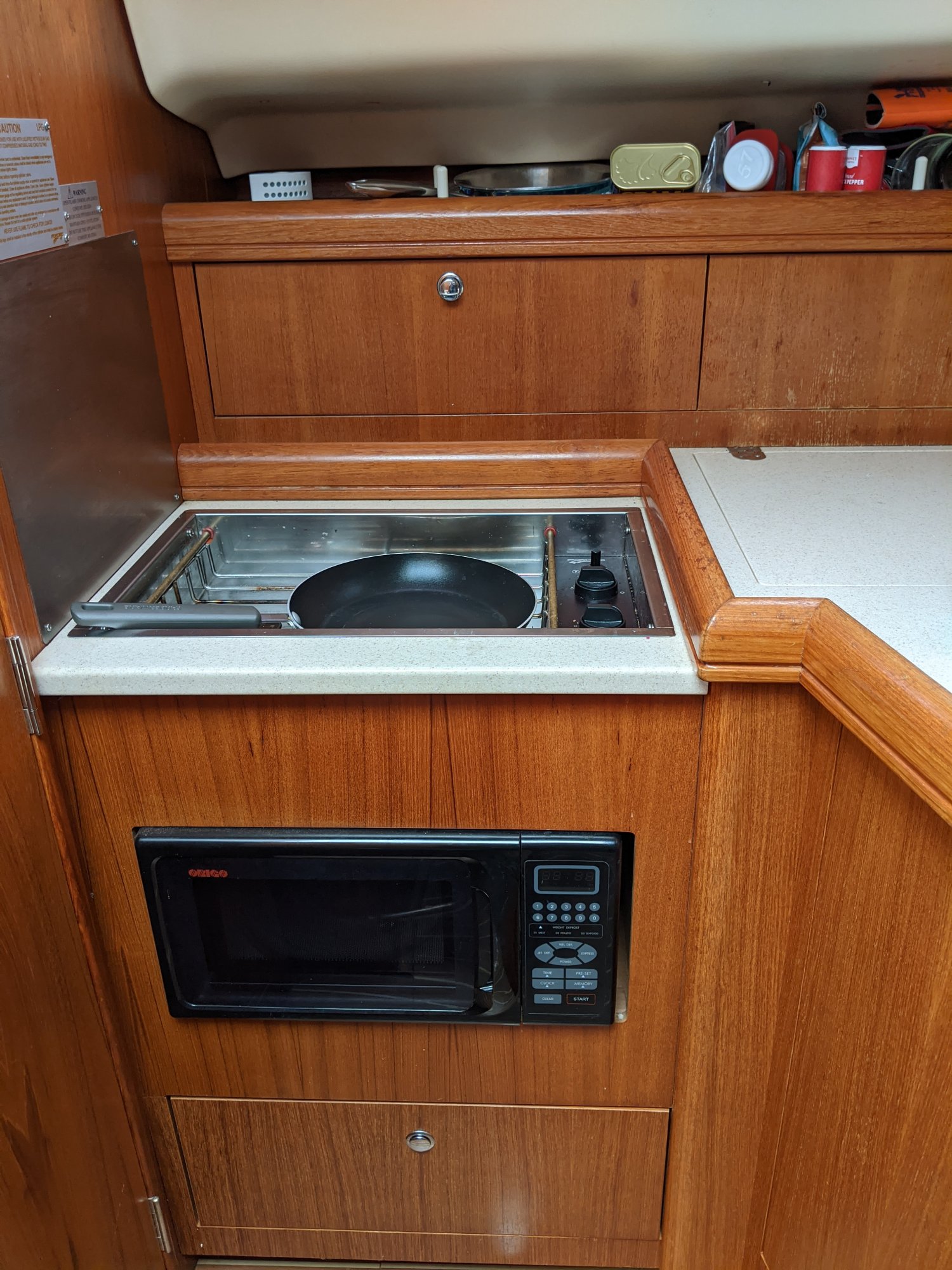

I just purchased a Hunter 306 and "am learning my way around." I noticed a white 3-strand AC wire marked "Microwave" starting behind the control panel and terminating in the bottom cabinet/drawer below the stove. Does anyone know what brand of microwave, and where and how to install a microwave oven below the stove?

Mine came with an exotic Origo, but as jssailem noted, you could put whatever in there as long as it fits. No trick to installing really as long as there’s an outlet there, just plug in and you’re off to the races. I don’t use it all that much though, and you might consider just keeping that spot open for storage.

The Microwave should be attached to the cabinet by at least one point, that is approved by their instructions.
Otherwise you will find it on the Deck when sailing on a Heel. :facepalm:
