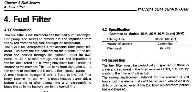

Yanmar designs it engines with the filter size of 2 microns to protect the fuel system high pressure pump and injectors - this is why the small filter mounted on the engine is fitted with the 2 micron element.
On older non common-rail Yanmar engines the on-engine Yanmar filter is not 2 micron. It is rated as a 10-15 micron element.
If one were to purchase a Yanmar branded primary fuel/water separator filter, from Yanmar, it is 30 Micron and nothing more than a re-branded Racor. The Yanmar Part number for the whole kit is 4230B and the filter cartridge only is 4230-0100.
1,090
I stand corrected! What is the point of diminishing return for filtering the diesel for an older Yanmar? Maybe I should go back to 2 micron in my primary Racor...
