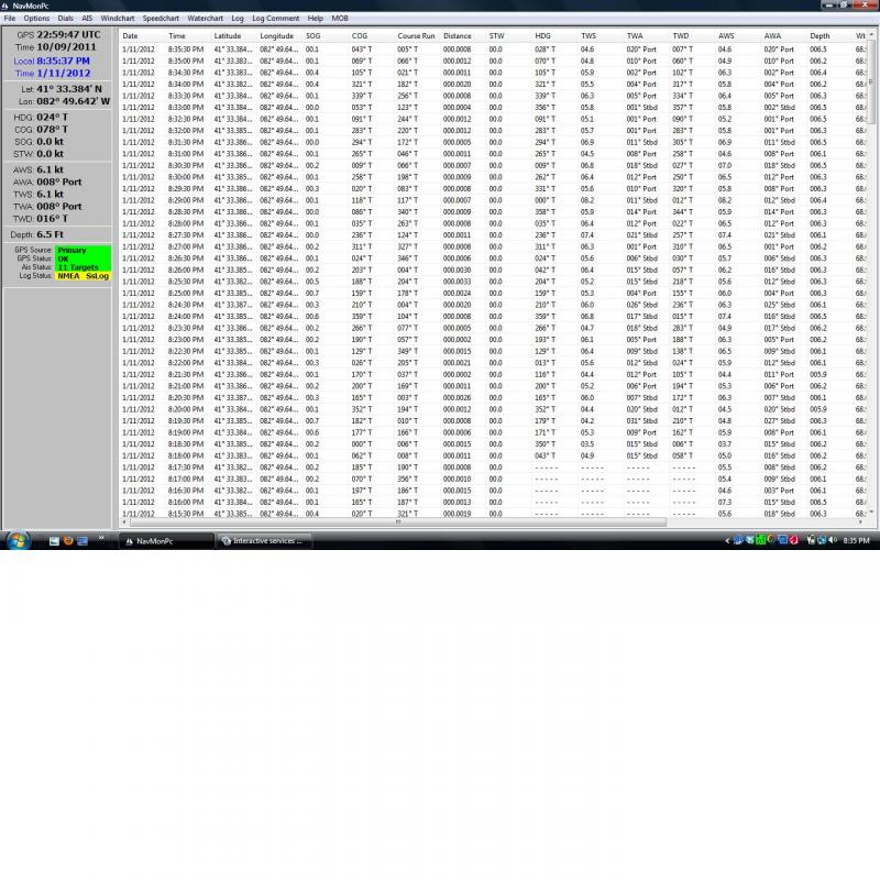

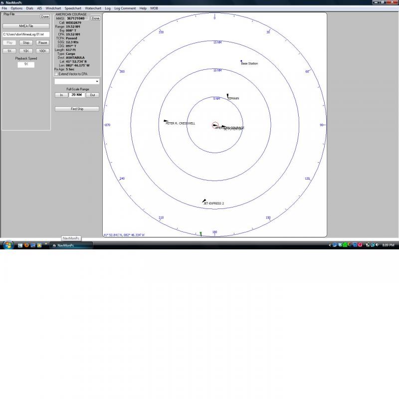

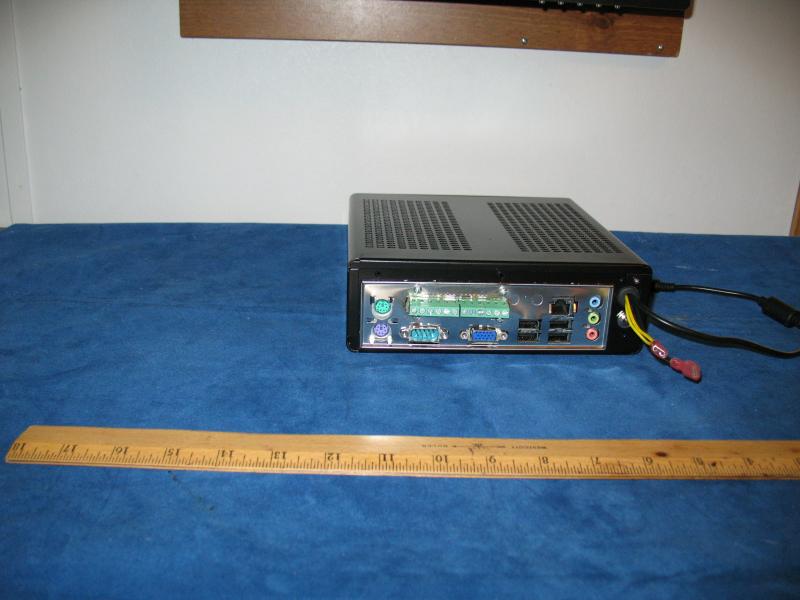

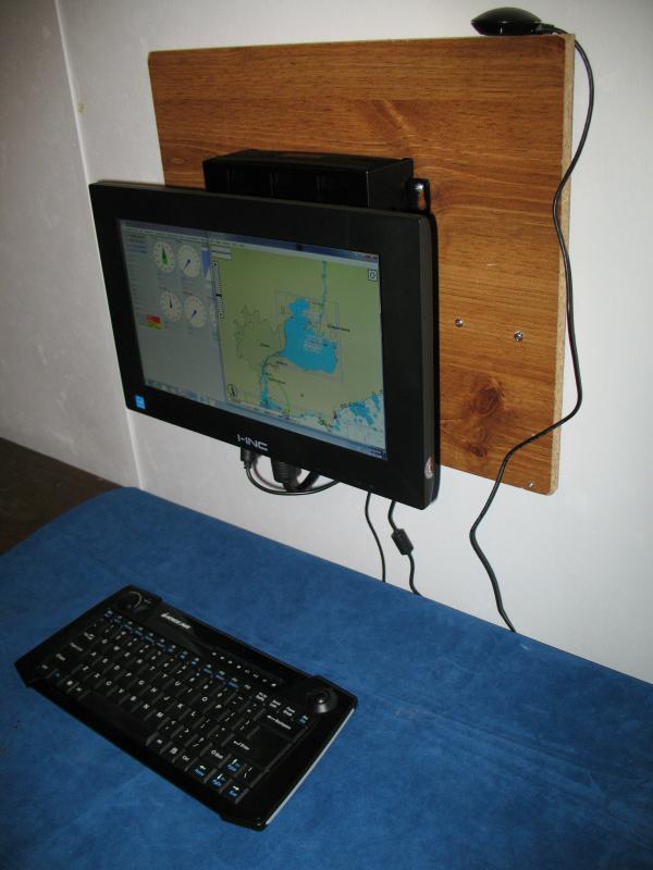

This last year I have been working on a more permanent nav station which I can afix to my Hunter 35.5. I find PC notebooks handy but they lacked versatility so I decided to go with a micro mainframe with plenty of horsepower. Since I could not find exactly what I had in mind, I and a computer engineering friend decided to design one from scratch.
As we started to build and test the unit we found many problems with interfacing free software to existing equipment at the helm and nav station. It took quite a while to interface various manufacturers' equipment (especially Ray Marine) together as one. After months of struggle we got it all to work together.
We also wanted a seamless power supply system using the least amount of operating power. Wiring to existing equipment was another issue. I decided to eliminate multiplexers and leave lots of options for expansion.

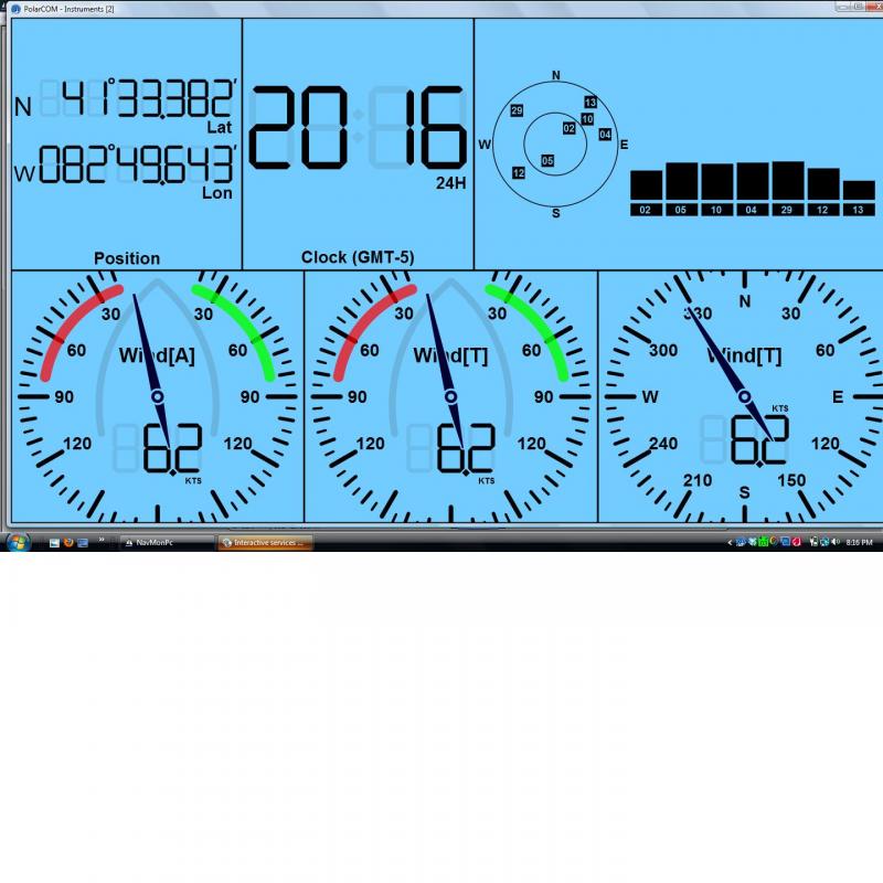

So far I have designed into one small box( 5) RS 232 ports(most of which have only the 3 connections necessary for NEMA 0183) , (8) USB ports, and a special wide band power supply which can go from A/C shore power to DC battery automatically. We also tinkered with the DC supply so it will not blank out when various pumps and compressors turn on. I added a long range internet antenna, a built in router for PC notebook use so I can watch my nav station remotely and now am busy interfacing weather faxes from a SSB receiver. My power consumption is 40 watts but can drop to 10 or 20 watts when in automatic sleep mode while still trending and entering information into my ship's log.
I put plenty of horse power in the computer with 4 giga bytes of ram and 250 giga byte of hard drive using windows 7 operating system.

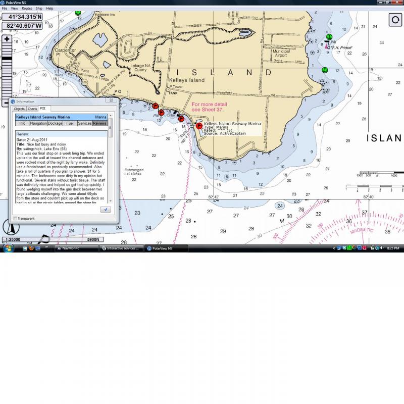

The navigation software I'm using so far is Polar Navy (a very inexpensive chart plotter) that also can display all my helm instruments and give me Active Captain information about various marinas and ports. I am using the free NavMon PC program for trending, wind information, AIS, ships log , anchor watch etc. Open CPN is also linked in for charting and planning purposes. I have all the NOAA charts integrated into these programs as well.
Now we are working on a security camera system which will alert my Iphone to anyone near my boat while I am ashore, a multiday barometer graph for better weather forecast, and tank monitoring.
Here are some pictures. If you are trying to make a similar system perhaps I can help. If you have solutions to my latest projects maybe you can help me. I even thought about marketing this project to anyone interested.

Wow, I am amazed, we had the same idea. I built almost the same machine using the same enclosure you used. Looks like we chose different mother board from the look of your back panel. I went with the Intel Core i3 2100T processor for lowest power.
My rational was a little different. I built something that can act as an entertainment system as well as for navigation (leaving with the wife and kids for a 2 year cruise down south starting next fall).
I installed windows 7 and Ubuntu as a dual boot system and taking advantage of the best of both worlds.
