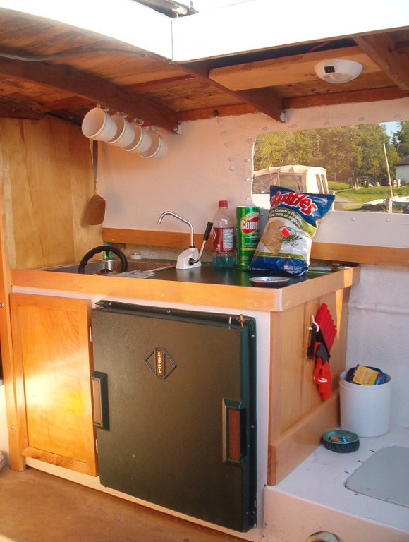

Yankee Condore 21 Halifax
Here's our little galley. We're on a 22 footer so more room. We use a 2 burner propane camp stove currently stored in the aft port quarter berth locker. We can easily store a weeks supply of food in the foreward locker on the starboard quarter berth. We have a 20 gallon water tank and our msd is a 2.6 gallon with seaside pump out or dockside.
We have all of 46 inches of clearance in the cabin for height but it is a roomy boat do to the cabin design.

Nice job! That pump is the same one i am planning on using. Does it work well? I like the hanging cups, do they bang?
Hiee,
Thanx. The pump moves alot of water but has alot of pressure to. When it squirts into the sink it usually splashes up onto the forward bulkhead and cabin sides. I will be pushing on a length of 3/8'' braided hose that will entend the nozzle to the bottom of the sink. Hopefully that will eliminate the problem. The cups click once in a while but not very often.

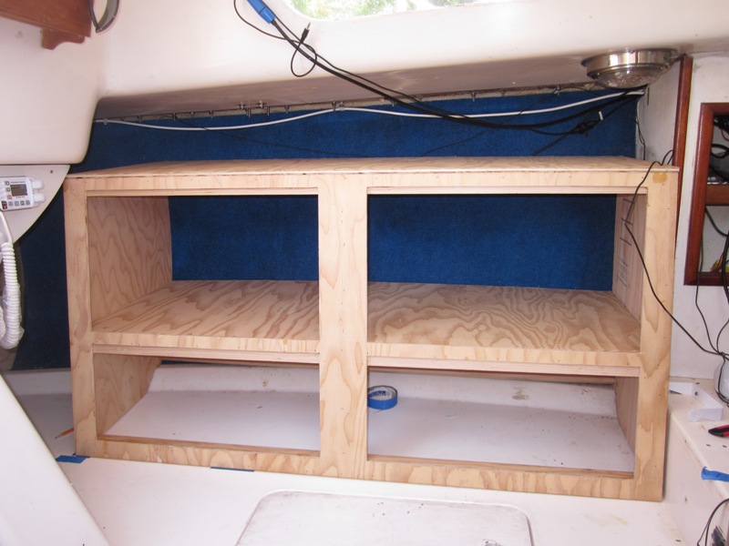

I was having a hard time trying to figure out seating for my boat and so am somewhat copying his portside mod. I'm doing this on both quarter berths and each will hold 5 Rubbermaid 19 qt bins on the second shelf and room under for shorter bins. I'm doing a fiddle around the top to hold small items. I'm using the hull for the back and the QB for the bottom. It'll be bolted down through the QB in 4 places.

That is looking great! That is the location of my galley idea as well. Both sides too. The only difference is since I dont have lockers on the cockpit seats, I cant get below. For that reason I will be mounting the galley's on sliding tracks so that they will store under the cockpit.

My project started because my cabin seating sucks. The hull is so far back that it can't work for a back rest and I hit my head on the underside of the deck.
Sliding the galley out of the way when not in use makes sense.

Merlin, will have pictures soon. I have the plans drawn and ready to cut. Just need to find some nice plywood to use.
