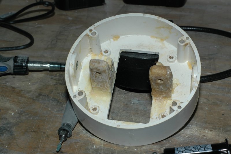

There are no more parts available. HMP (Holland Marine Products) in Canada is willing to cast new shifter plates for re-sale if a customer is willing to send in an old one as a template. I would have sent mine up there but it broke mid season.

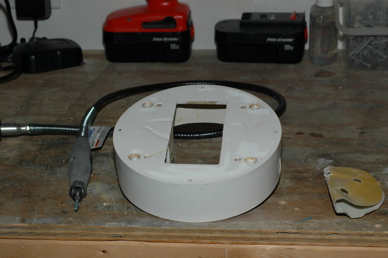

I repaired it with Devcon Plastic Welder, 1" fiberglass tape, Dremel and sand paper. It's still working fine. I painted the finished side with Krylon Fusion but left he underside raw in case it breaks again.
If you are hauling out for the winter call HMP and see if they are still interested in casting a replacement.
Routing he cracks for repair:
