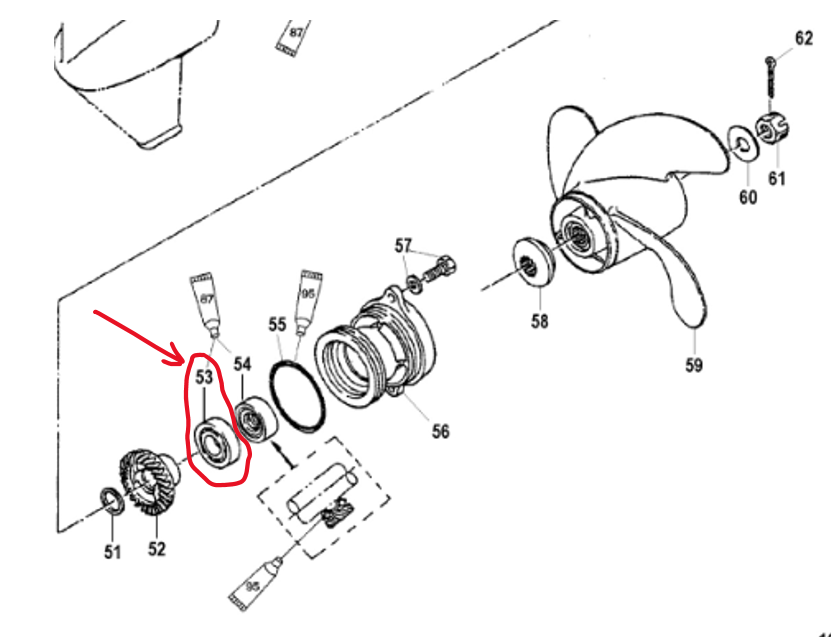

I'm in the process of trying to sell a 2004 Mercury 4hp outboard (NO, this is NOT an ad to sell it!!). Back in October I brought it home to get it ready to show over the winter I realized the shaft seal was leaking oil. I dutifully took apart that section of the lower unit, and ordered the appropriate replacement parts online. Only a few parts needed to be replaced, including a bearing. I looked everywhere online and couldn't find the bearing in stock anywhere, even e-mailed a couple of Mercury authorized repair shops in MD, but no one had the part. The parts supplier I'm working with initially said Mercury promised a November ship date, but it's now January and they still have no idea when Mercury will make the part available. The 2004 parts are common with all the later models of Mercury 4hp outboards, so it's not a case of it being so old they don't still supply parts for it (maybe that's wishful thinking).
Has anyone else run into this issue with Mercury outboard parts? It's been 4 months since I originally ordered the part. Are there substitute parts for them (e.g. like the same motor being sold by another manufacturer)? Kinda tired of this thing sitting in my garage torn apart. Will really stink when snow finally arrives and my 4Runner is still out in the weather.

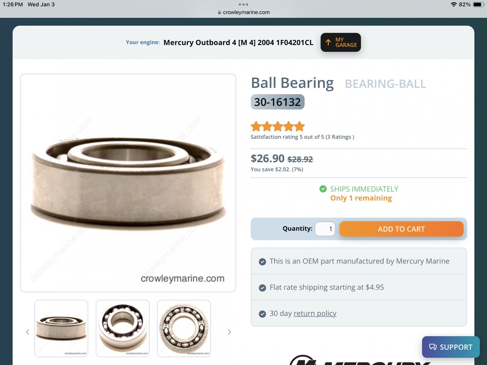

Just took your advice and looked for a cross-reference on Tohatsu motors. Kind of a bad news - good news thing. Turns out the Tohatsu parts are even harder to get, but in looking for the cross-reference I did run across the parts in stock on marineengine.com that are genuine Mercury parts, and a few other cross-referenced substitutes. That site seems very handy for cross-referencing like that.

Here's what's taking forever:

I just ordered one of 2 "in stock" at marineengine.com. We'll see if that turns out to be true. It wasn't with the last vendor.

I read where you said you ordered the part, but your not that confident about getting it.
Did you try Crowley Marine? When I typed in your reference number it came right up as available.

Crowley is where I ordered from back in Oct, and they did deliver all the other parts I needed except for the bearing. A couple of times the part has shown as available when I check their website, but when I ping customer service they consistently say "Oops, sorry, not available" and change their website. I will say Crowley is SUPER responsive, even if their website isn't always accurate as to parts availability, and they are dependent on Mercury in this case, so it's not their fault the part isn't available. I would order from them again, but this particular part they haven't been able to come through.
