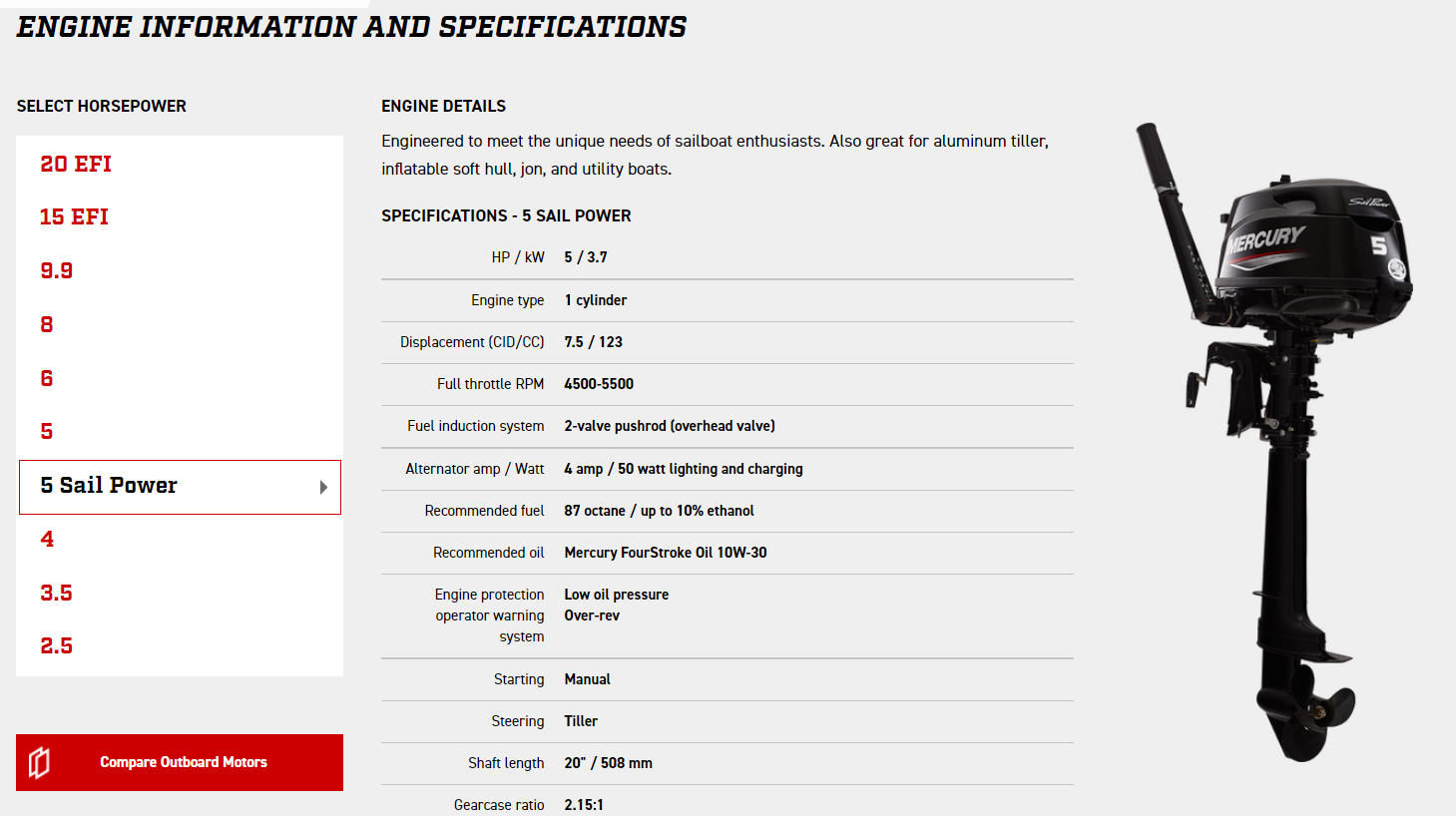

The thing about the Tohatsu is it has an alternator that the Merc doesn't have.... Not as far as I can tell at any rate.
Besides the high thrust prop, and long shaft... Alternator output is a feature of the Sailpro version. Hopefully the Mercury Sailpower has it too.
Worst case the Magneto parts from the tohatsu should fit. Unless something has changed in the last 2 years, the only real difference is the stickers on the engine.cover.
That said, if.you read the threads here, the 6hp can push a 22ft hull easily. We rarely used ours past half throttle. (Idle when in the marina). That output is dependant on RPM so you don't often get full rated amp output, if ever.

Online outboards has the long shaft and.ultra long shaft Sailpro in-stock right now.
While the engines are made by the same people, the fact that the tohatsu Sailpro comes with a larger prop (8 vs 3 inch), an 3 gallon external tank (vs 0.3 gallon internal), is 6hp (vs 5hp), a 5 year (vs 3 year) warranty and also available as a 25 inch ultra long shaft... I figure the Sailpro is a no brainer... Especially when onlineoutboards.com.has them in stock.
I bought mine online from.them. no problems.

I bought mine two years ago. Mercury 5 hp sail pro: long shaft, high thrust prop, little alternator- lette that I’ve never actually installed, propane fuel.
