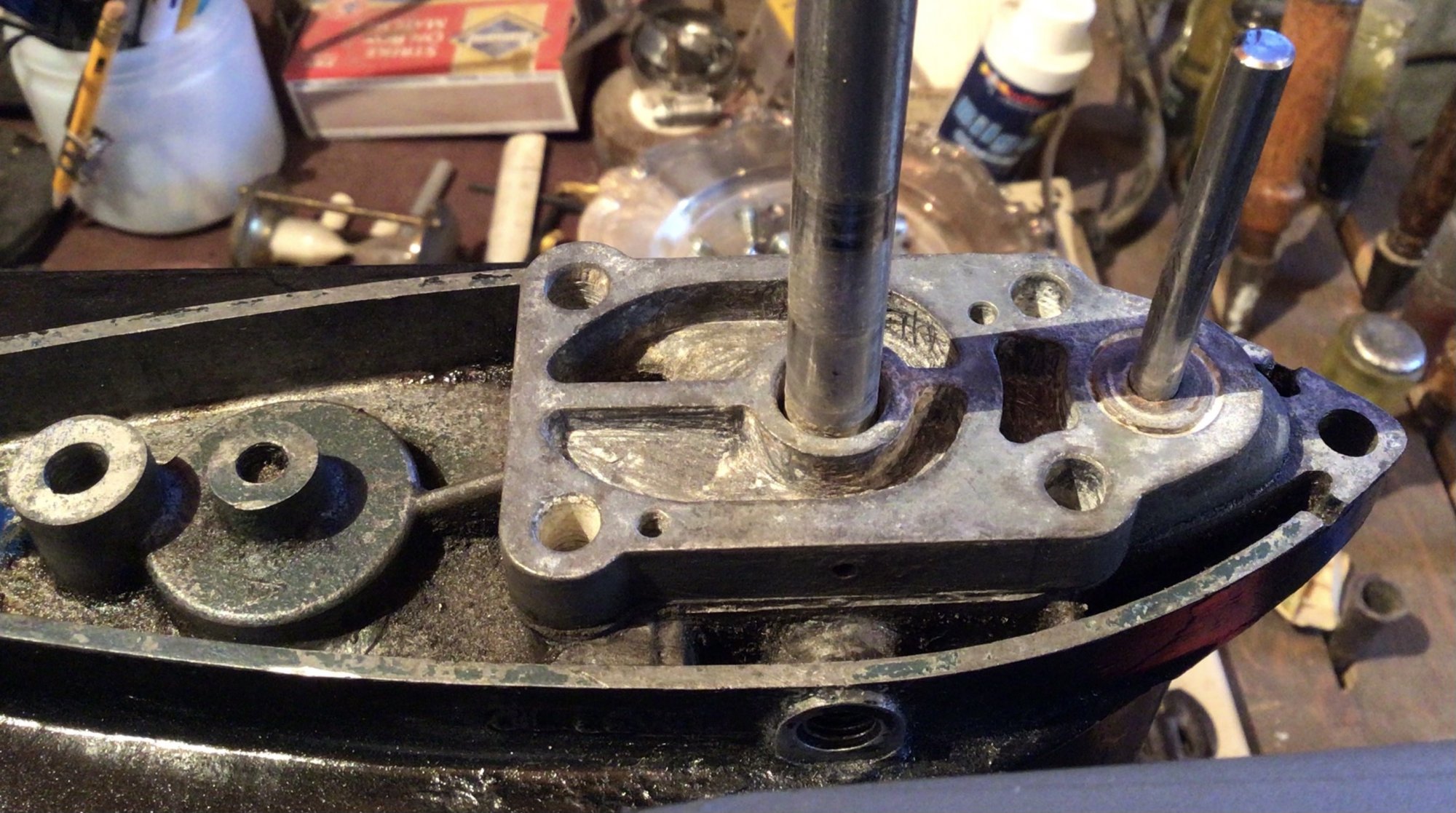

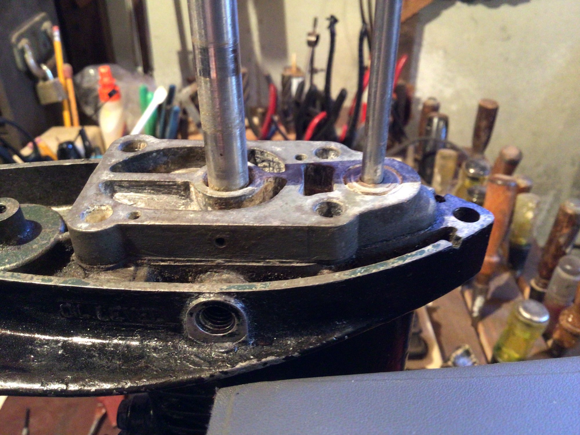

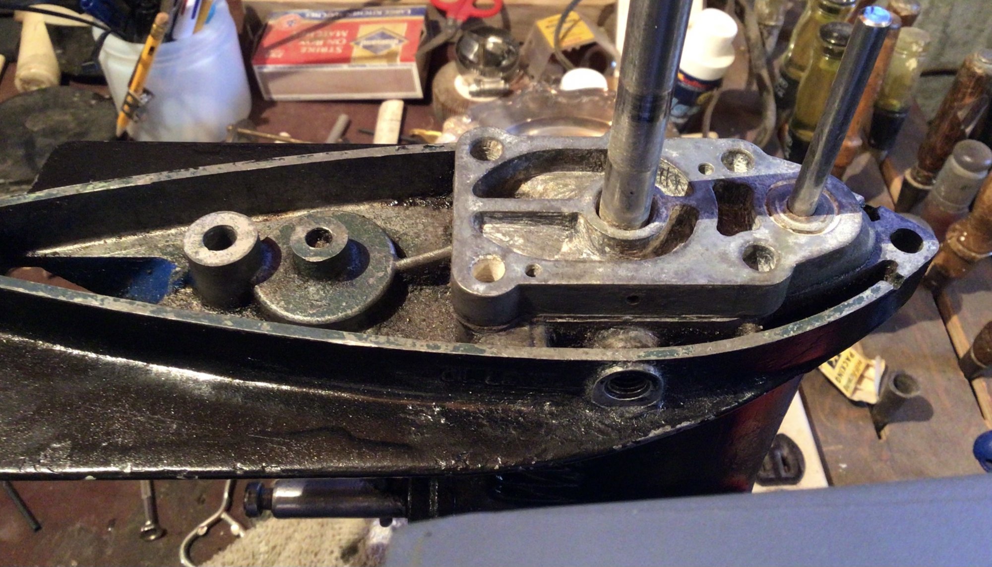

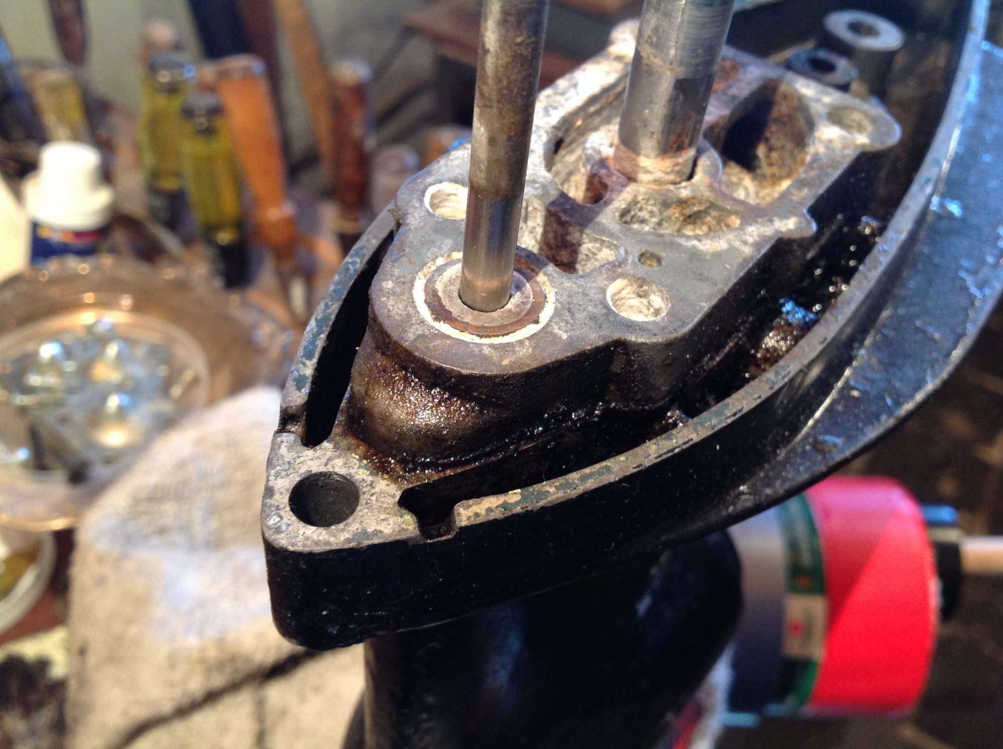

I know this is an older posting, and don’t know if you have done your repairs to your lower unit. I just dropped the lower gear unit from my 3.3 Mercury to replace the impeller. Admittedly, it’s been a while since I’ve replaced it.
I found oil seeping from the under the Pump Housing.
I’m bringing this up because there is an oil seal inside the housing. And if oil is coming out, water could be going in and contaminating the oil in the gears. You said you found air from your pressure test escaping at the O Ring Seal and I hope it is your leak area but it’s worth looking at the Pump Housing of your outboard.
I also found a lot of salt deposits in the Housing which was slowing the flow of water throughout this system. I have enclosed some photos for you to look at. The salt you see is what’s left after I tipped it upside down and banged out the big chunks.
Next will be to remove the Pump Housing and replace the Oil Seal. Not looking forward to that, as that Housing is in there pretty tight on a good day. And not a big fan of tapping on 20 year old parts to loosen them. But that gasket needs to be replaced at least.
So I’m not wishing you more work as much as I am hoping you don’t see what is in my pictures for yourself.
