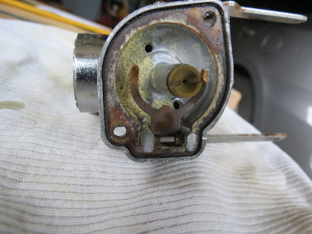

Here is a picture of my Nissan carb BEFORE cleaning:
Spotless afterward.
