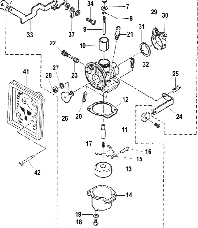

I had basically the same problem with my Nisson 3.5. Drove me nuts. Finally I replaced the carb bowl and if I remember the high speed jet. I also put in an aftermarket inline fuel filter and replaced those spring fuel hose crimps with hose clamps in case they were leaking air. All that cured the engine. It was as Rich said. Little flecks of the aluminum oxide from the bowl were clogging the jet.
Can you point to which jet you replaced?
