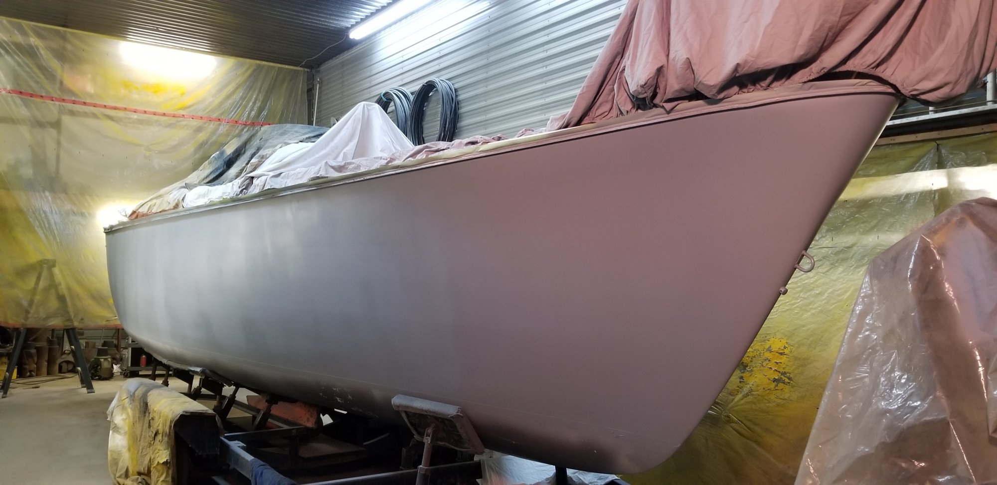

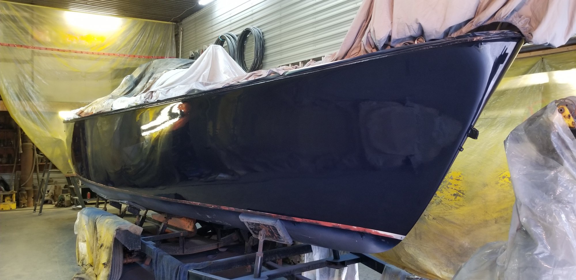

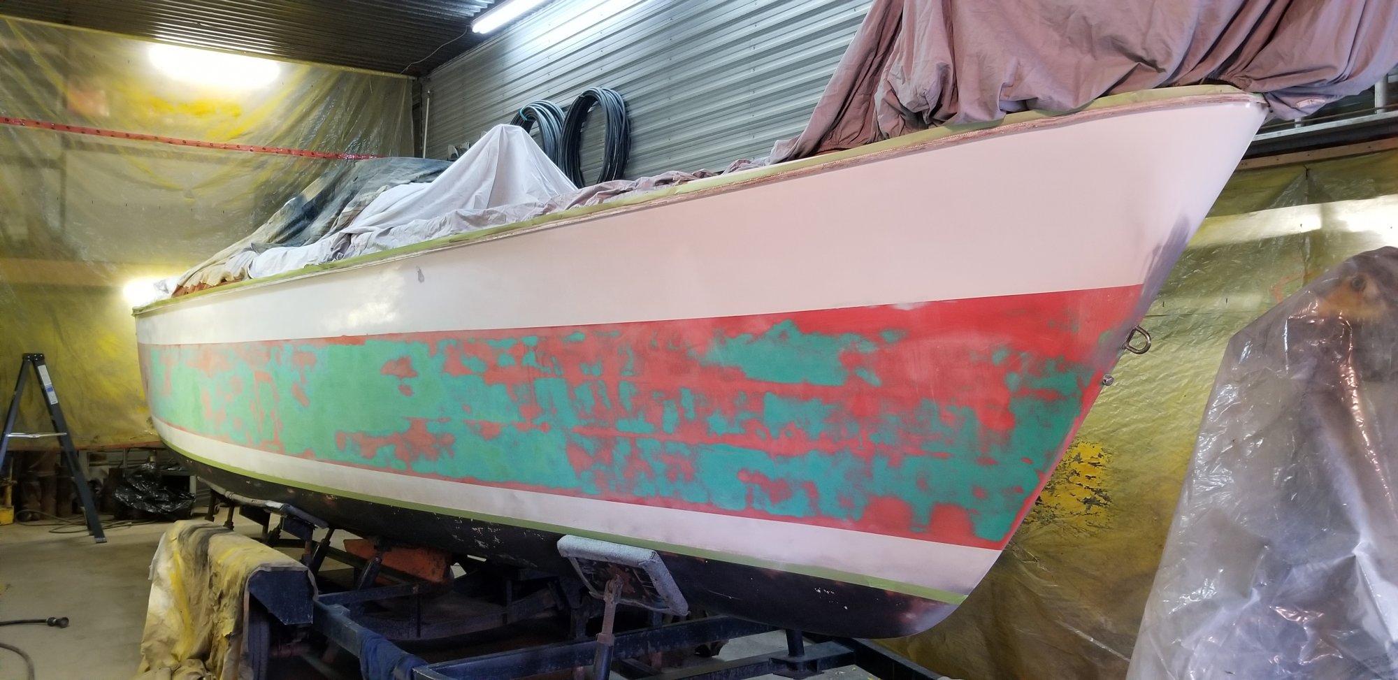

My mega 30 that I got free is coming along. sanded it back to gel coat (the various colours of it), fixed up some fiberglass and now it's got some primer on it! Hopefully tommorow the topcoat can go on and my nerves hold enough to get a nice coat.

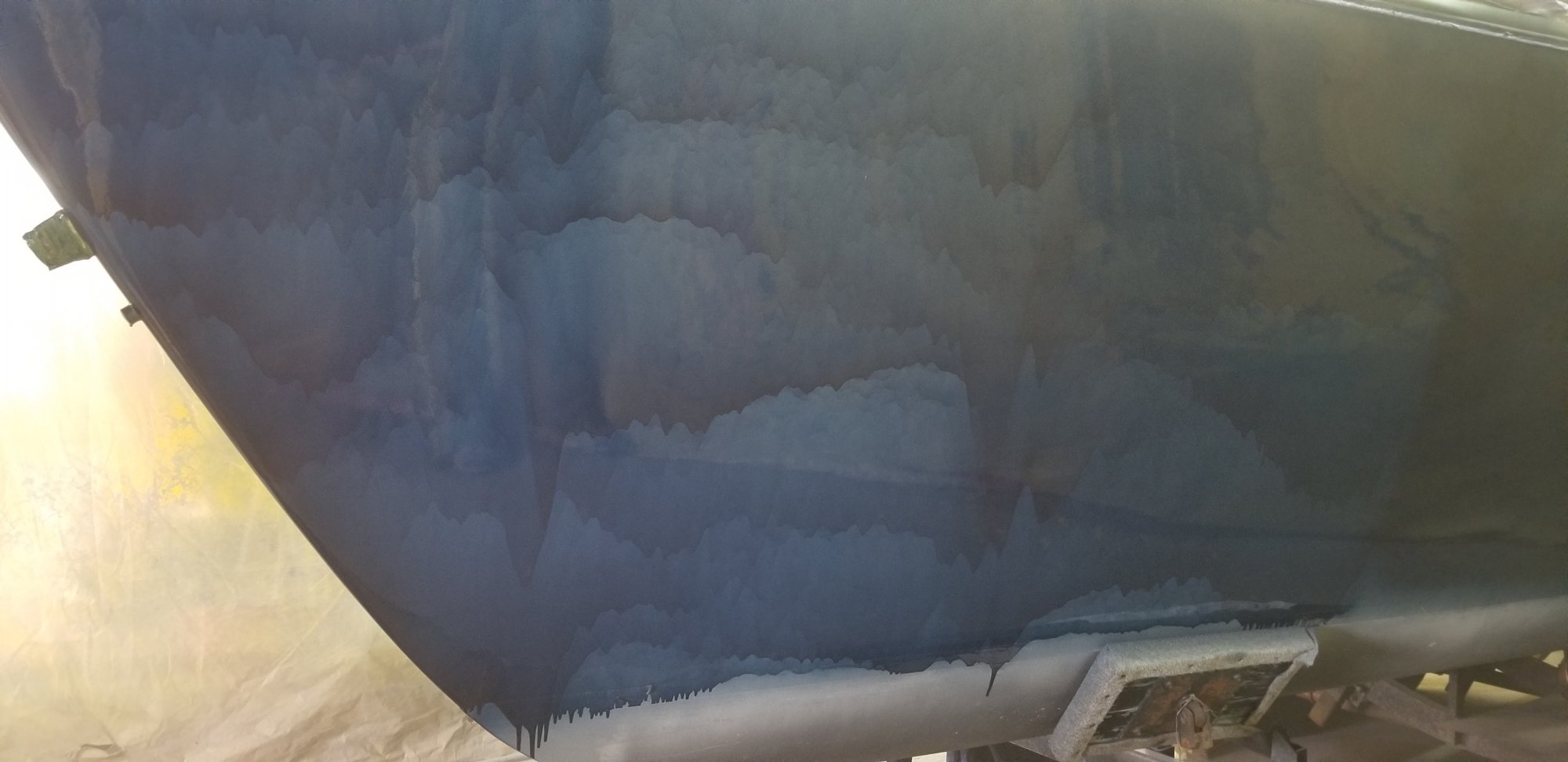

Many different types of paint sprayers out there and no one has mentioned type so pressure may be irrelevant. 80 psi in an HVLP or LVLP maybe not. Basic gravity feed maybe. Let's get the facts on type before we start throwing ideas out. Looking at the pictures I would be "guessing here since I really don't know" would be temperature of product vs surface. Just guessing.For what it's worth, any and all of the spraying I've done over the years, both automotive and marine, I've never sprayed with less then a consistent 80 psi at the nozzle...and have never had the issue you are having.
I did say conventional which ever since hvlp came out people have forgotten the meaning of, basically the same but smaller air holes on the cap so a slightly higher Pressure at a little less cfm but not noticeably different in operation.Many different types of paint sprayers out there and no one has mentioned type so pressure may be irrelevant. 80 psi in an HVLP or LVLP maybe not. Basic gravity feed maybe. Let's get the facts on type before we start throwing ideas out.
