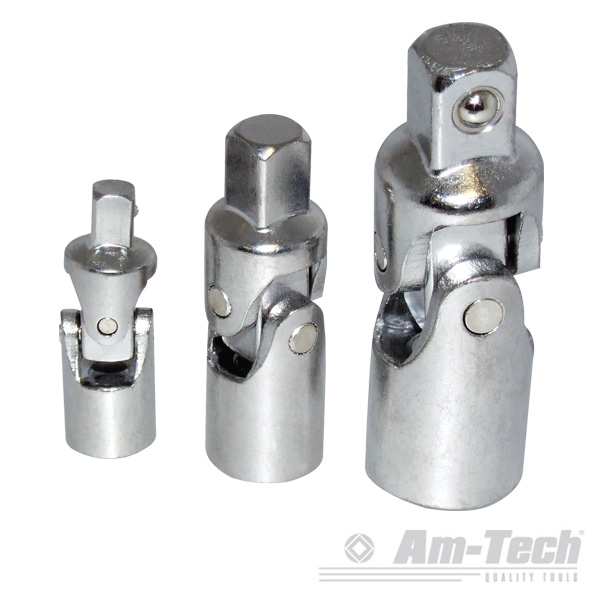

In these cases, specialty tools can be useful. The box-end ratchet wrench and socket knuckles come to mind.
