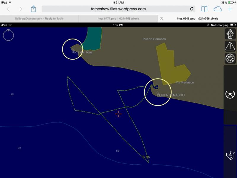

Image of track was with winds of about 3 kts, maybe.
Likes: captain69
