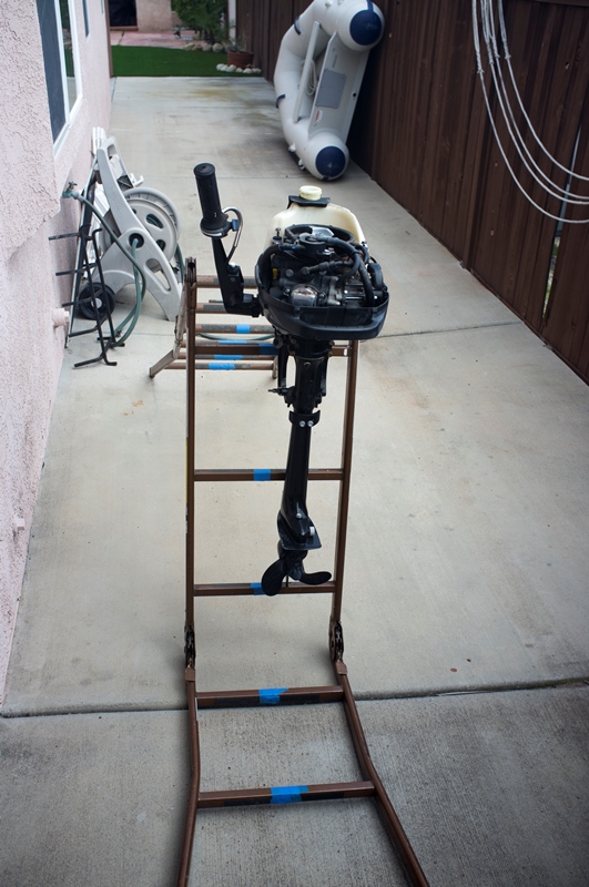

Did all the work that I said I would do. It did fire up but will not stay fired up. So, off with the carb. I just don't like working on carbs. Maybe there is something I can spray in the bowl and let it work it's magic.
So, either this setup is the Marine in me (Improvise, Adapt, Overcome) or the Red Neck in me. LOL

Used to be an old boy at our club that would clear a stuck float by turning the OB upside down and dropping on it's head on the dock. Worked every time! ;-)
