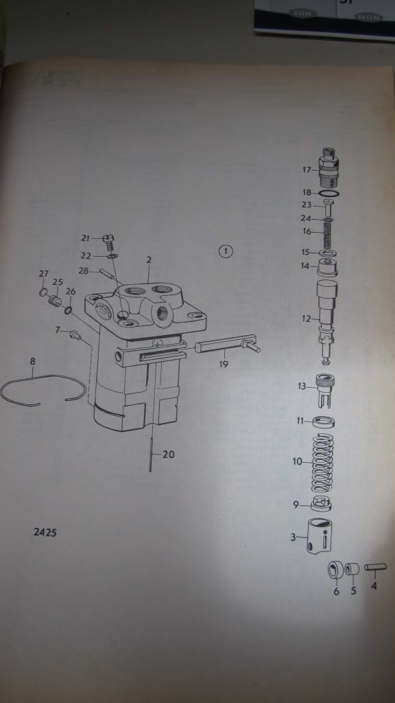

I ordered the O-rings and some copper washers to see if I could fix the problem without removal of the whole pump. They are numbers 18 and 15 in the parts diagram
Scrubbed top of injector pump with WD-40 and a tooth brush to clean it up. Removed fuel supply line to top of injector pump (17mm wrench). Removed injector lines off injectors and injector pump (17mm wrench) Removed fuel return line (10mm wrench), Remove oil filler cap assembly (it was in the way). Shove paper towel down the hole uncovered by the oil filler cap to keep crap from gettin' in the gears.
Remove a little keeper dealy-bob between two of the injector delivery nozzle caps. I think this dealy-bob keeps the center cap from turning when you're pulling off the injector lines because you can't get a wrench on it to hold it. 19mm deep well socket to remove each fuel delivery valve cap. There is a spring under there, but it doesn't go boing when you pull the cap. Under the cap is the O-ring and a copper gasket that needs to be replaced. Here is a parts diagram. Takes about 1.5 hours to disassemble and clean. Takes about an hour to put it back together.
Put it together this morning and it fired right up. No leaks. Hurray, we're going out to Hope Island to enjoy this weather while it lasts.
Great!! Glad to see you made progress. My delivery valves were sticking....BTW, I"m sure you're aware that the diagram above is NOT for an MD17. Little parts are probably the same though......Went out to Lopez Is and raised sails. First time since new rig. No wind....
