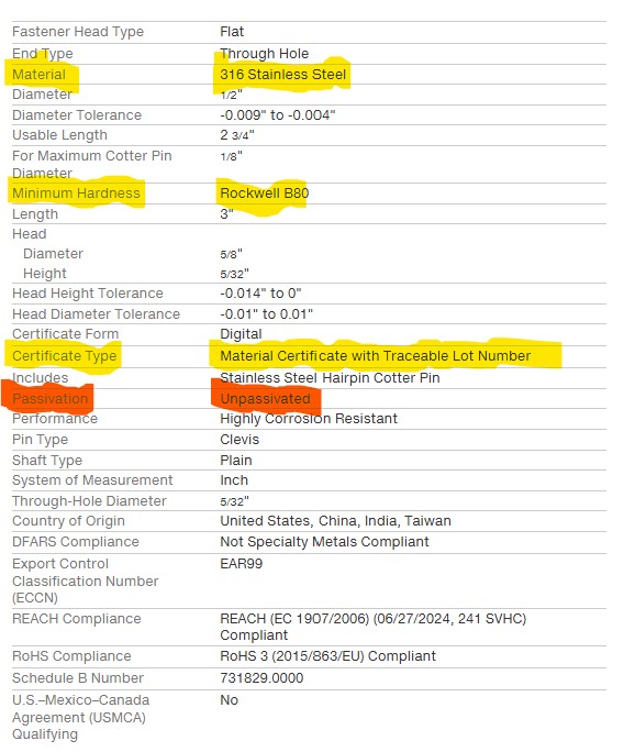

Hmmm, let me walk you through what you've got on the McMaster page saying what this material is. You have all the dimensional "stuff" which I won't address. I'm only going to walk you through the materials part that is published. I'm attaching a screen shot of what they say on their page.
First you have the material stated as "Material 316 Stainless Steel". You then see what you were asking about, the "Minimum Hardness Rockwell B80". Note below this you have "Certificate Type Material Certificate with Traceable Lot Number" - this last item I always ask McMaster to send to me - I'd suggest you do the same but that's up to you. Now also note that they have "Passivation Unpassivated"
The single most critical thing on that list that tells me I can rely on what they are selling me is that the supposed 316 has the availability of that traceable lot number. With that traceable lot number they are legally bound to provide 316 material - another reason I always request it. Once you've gotten that product and didn't ask for it - you have nothing to say that this is what you bought.
Now note that I also highlighted "Passivation Unpassivated". That would say to me that once I got this piece, I'll passivate it. It's pretty simple to do. Before installing, really you should passivate the piece, although lots of folks don't.... And you'll probably not have an issue. I just don't like the "probably".... Even when I buy fasteners like screws, nuts, washers and such, I passivate them myself. Especially threaded fasteners...
Long winded way to say - It doesn't matter the 80 HRB. That number is pulled straight out of the ASTM specification that the 316 material was produced to. It's just kind of "fluff" that makes this list look very "engineering". McMaster is really good. They hold their suppliers to very high standards. I used to work in an industry that produced product for McMaster so I know first hand just how high of a requirement they have to become an approved supplier to them. After you get approved, periodically they audit you.
The fact you can get that traceable lot number - and actually get the material certifications for this part means... Well, it just doesn't get better than that....
The fact you can get that traceable lot number - and actually get the material certifications for this part means... Well, it just doesn't get better than that.... View attachment 238564
