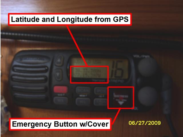

One more option
Most of the newer VHF radios have Digital Selective Calling (DSC) and can accommodate an input from the GPS. If so, then all the crew has to do is lift the little plastic cover and hit the red button. Boat ID, latitude, longitude and time go out in a digital encoded message leaving no doubt who you are and where you are. Much easier to remember and pretty simple to set up.
A lot of the new handhelds now have GPS built in so I expect they would work about the same. Here is a picture of mine.
Note: I added labels because PaulJ really likes labels.
