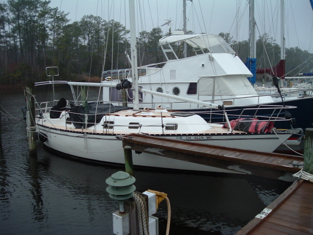

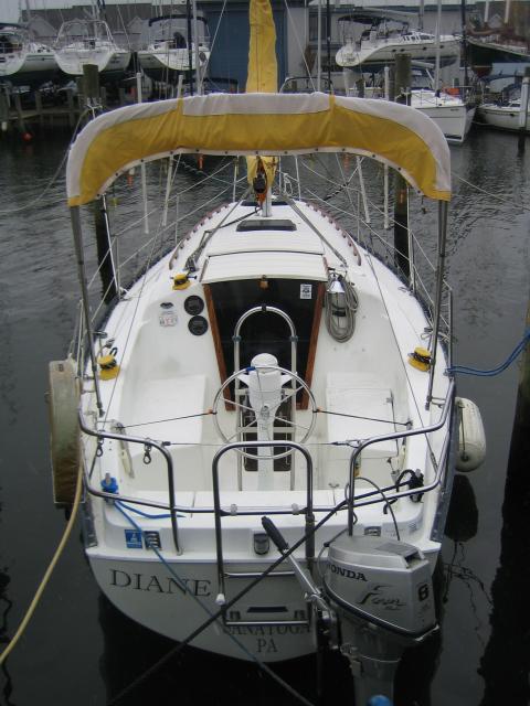

Well I moved my boat yesterday to the marina next door for winter "wet" storage. This is my first experience with fixed slips. Two people helped me tie up on the slip when I brought it in, but afterwards it dawned on me I'm going to struggle getting in and out when single-handing. Here's the setup: Two pilings at the front which are pretty far from the bow. I have a line from each piling to the bow cleat. I also have two lines from the front pilings going roughly midship acting as spring lines. I then have two stern lines crossed going to pilings at the rear of the slip. Where I am foreseeing difficulty is when untying the bow and spring lines I will need to have time to somehow loop them up and hang them on the front pilings using a boat hook extended all the way. My boat gets blown around pretty easily and I can see my self ending up partially in one of the slips on either side of me before I get two lines stowed :doh: The stern lines I can probably toss up onto the grass behind the slip, but knowing me, they'll land in the water and wrap around the prop :eek:
I'd appreciate any advice or constructive criticism. I know there are quite a few people that single hand from fixed docks - how do you do it? I could see if I had a bigger boat it would be easier, I could reach the pilings easily and push off of them if necessary.
There are also two pilings towards the stern, I had to put a line around that so I could pull the boat closer to the dock. I almost ended up in the drink about four times yesterday.
The pictures attached should help illustrate the setup. You can't tell but it was snowing while I took them. (One picture is of my drive home - lots of snow!)

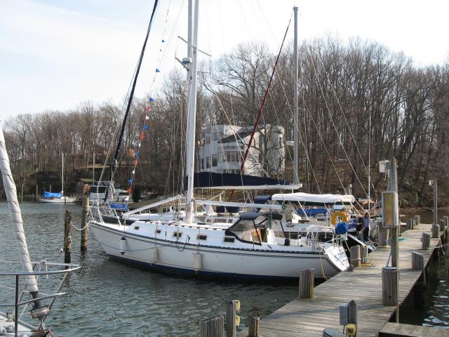

Manny's new slip.

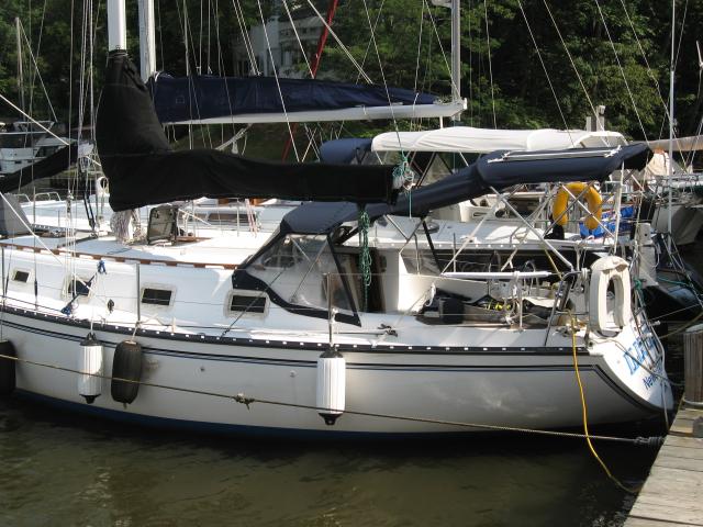

Are you required to dock stern in? Looks like all of the boats in your picture are stern first. My H37C is in an identical slip to yours. I would never come in stern first. Almost no one in my marina does. But especially not without an open stern. I applaud you for even being able to get in and tied up. And I don't think it would be any easier with my 37.
I come in very slowly and with fenders positioned for the finger dock. I have a permanent spring line between the starboard aft piling and the finger dock(which happens to be starboard). That line has a heavy snap shackle tied in the middle. I first hook that to a marked toerail position. The boat stops and I can hand over hand to the finger dock and jump off with both bow lines. I tie those very loosely. Now I can use that same spring line to pull me back to the stern pilings to tie off there. I do not cross lines because they will wear on the gelcoat. Trick is to get the slack properly set for water level changes. There is almost no tide where I am but I have seen a four foot change, mostly due to the direction of the wind.
If you are required to tie up stern first I cannot help.
Update: just noticed in the picture that you cannot see the stern docklines. The pilings next to the cockpit are not the ones that I am tied to. They are further back. I will admit having that middle set does make it easier.

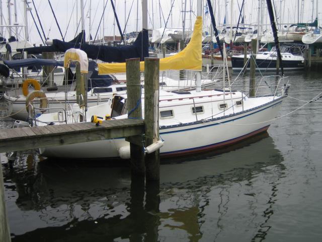

Manny over at Owens we run line from the outer pilings to the dock side piles and clip on to those when we come in. If we clip onto the weather side the boat stays pretty much in her slip.

Manny, I agree you should be pulling in bow first. You should have a spring line going from the right rear piling to the front of your boat, this will keep you off the finger pier. You should have lines separating your slip from your neighbors and they should be as tight as you can get them, they will loosen over time. I also agree in this instance you shouldn't be crossing your stern lines. Once you get your slip rigged don't forget to leave your lines as loose as you can to allow for exceptionally high or low tides,both of which are common in your area in the winter. Good luck. Ray T
10,253
Yes, cheap half inch nylon braid lines from the forward pilings to the rear at about half freeboard height at normal tide. These can guide you back. Stern first is more convenient to load and board.. Release lee side lines.. Work the winward side lines.. Use the rub rails to pivot if necessary. Ya got it! It is not elegant at first but soon, the "Dock Committee" will be grinning.

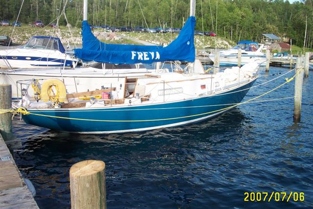

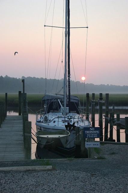

and finally here is a picture of what others are talking about
This is a friends boat, and he too insists on docking stern to. As you can see there are lines from the outer posts to the nearer posts that he can come up against when either coming in or going out. Essentially, He pulls one of the line so that boat moves closer to the post, then tosses the line over the post, goes to the other end of the boat and does the same, then to the windward side of the boat, undoing the fore and aft lines. The boat is now free to float up against the fixed lines but if he is fast enough, (seldom) he can put the running motor into gear and avoid the posts. Most often however, he is hauling himself out of the slip, hand over handing one of the fixed lines, then running back to put the motor into gear.

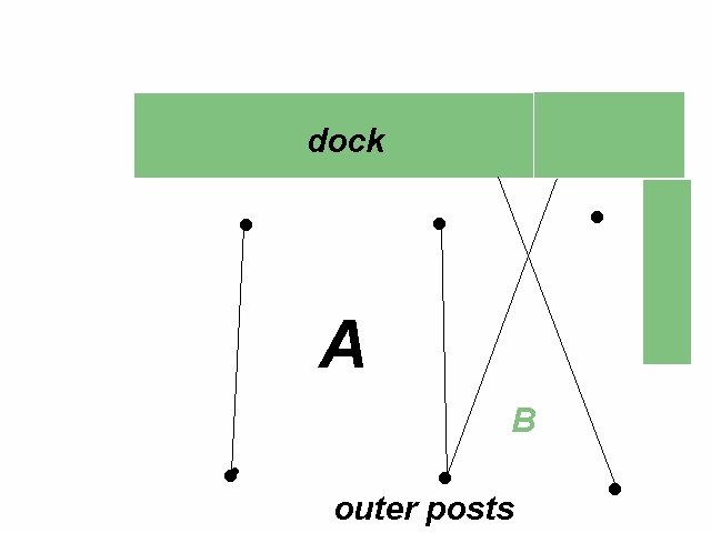

crossed rub rail 'catch' lines
This does not apply to your stern to arrangements, rather a bow to arrangement, but just to add to the discussion, I have seen this arrangement where there is cross current or cross wind that makes docking difficult. The crossed lines in B catch the boat as it is coming in, and centre it so that cross wind and current do not move it into the adjacent slip. This may be a slight improvement over the rub lines arrangement as shown in A.
In this situation the rub lines from the two outer posts run closer to a center point on the dock, but cross about 3 feet from the edge of the dock. Its this crossover that catches the bow when motoring in. From there you have to reach lines that you have previously left attached to each of the posts, to secure your boat. A boat hook can come in handy, but you can also walk your boat by using the catch lines to move it closer to each of the posts to get your lines.

Re: crossed rub rail 'catch' lines
Roger, on a lake that would work nicely but with fixed piers and a 3-4 foot tidal range you could sail under or over the lines.

good point ross
Even a couple of sets of lines set at different heights, may cause a prop wrap issue. My thoughts were indeed related to non-tidal situations however, so your comments are a good caveat for tidal waters.
