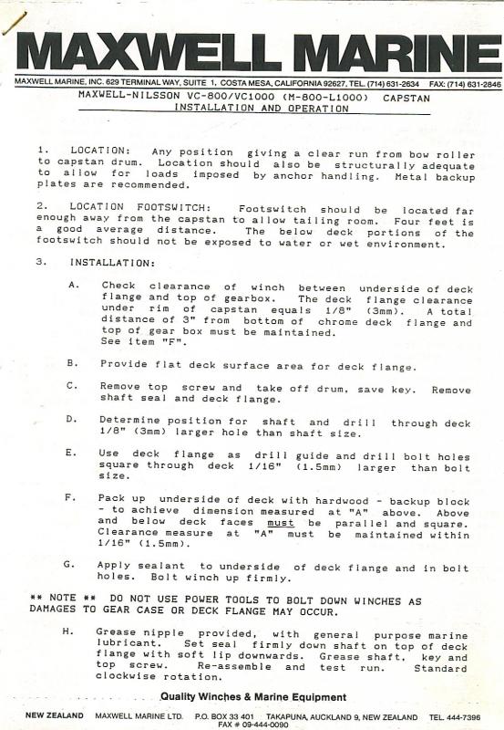

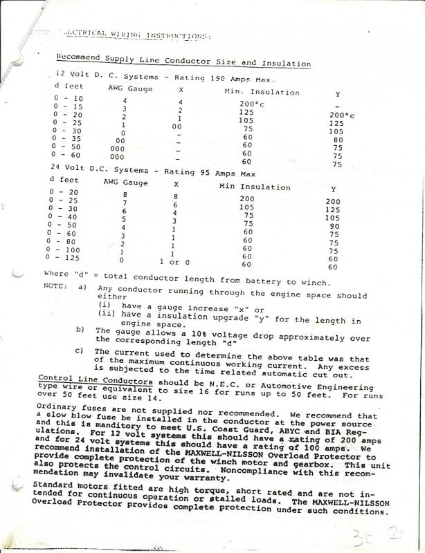

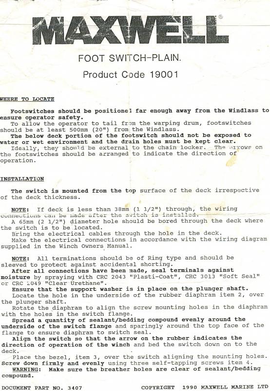

Hello Smokey,
I have a VC-800, it does not have the gypsy for the chain, only a rope drum. Perhaps you have a 1000, or someone upgraded it. Here is the manual for it. Hope it helps.
