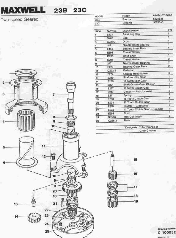

Hi,
Does anyone have the detail drawings on the Maxwell 23 2 speed winch? I believe they were original equipment on my 1987 H28.5. I took them apart for cleaning and now have a pile of gears and parts, more like a puzzle.
Thanks
