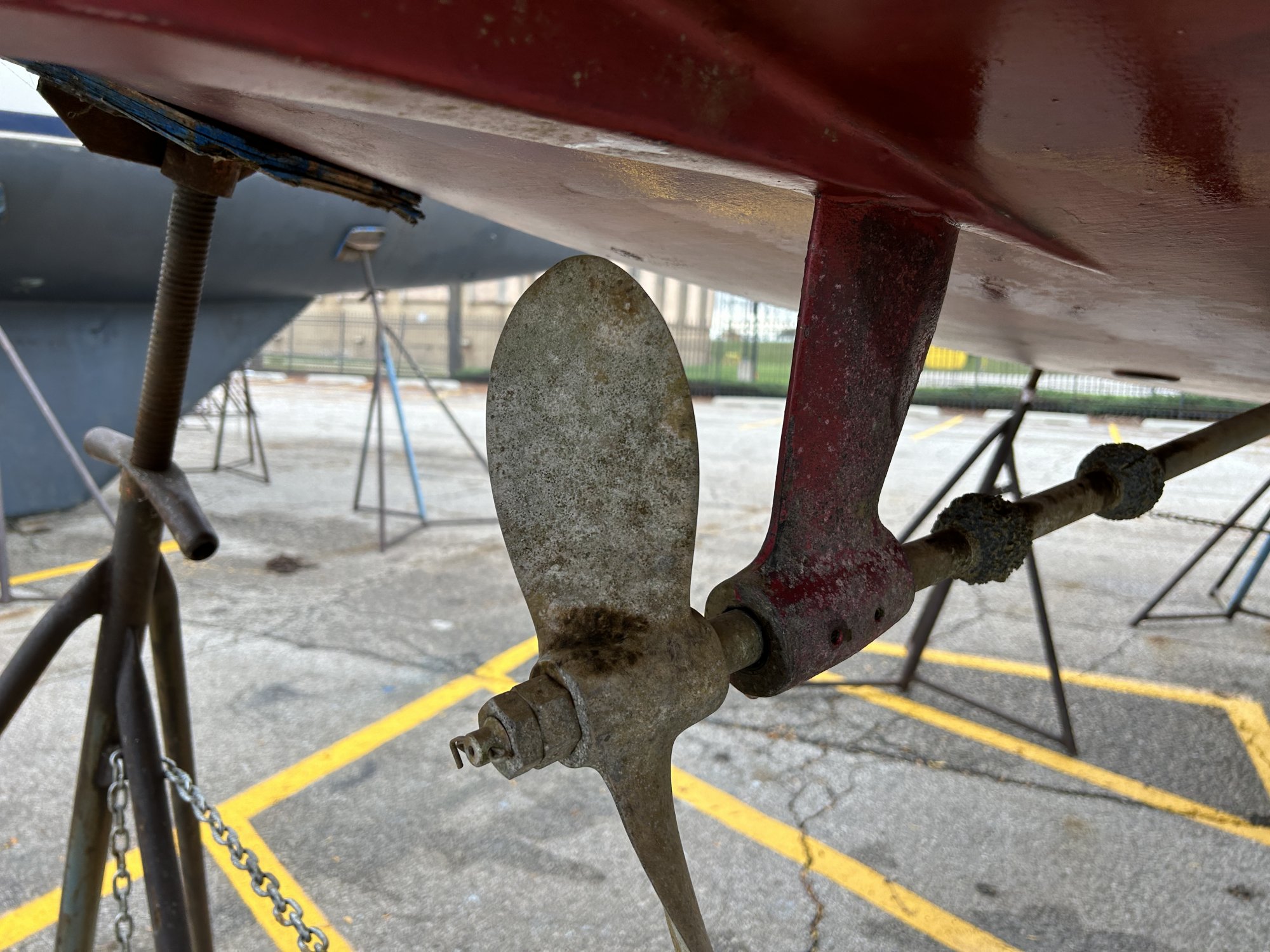

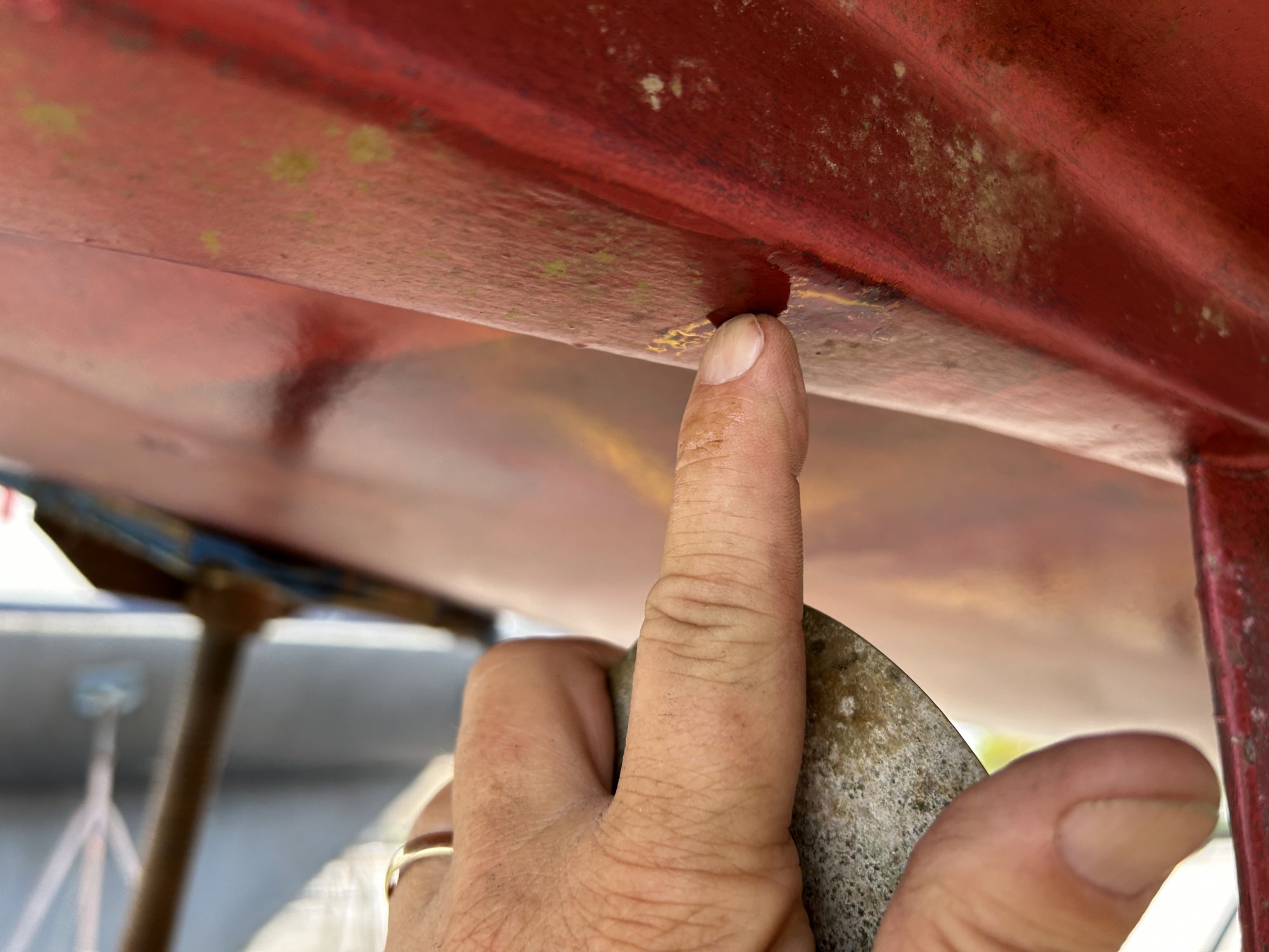

What is the recommended space between the hull and the tip of the prop?
My O’Day 322 has a 14x14-2 blade Michigan now. MaxProp recommended a 15x11-3 blade, but I have a bit of a skeg molded in the hull, and a 15” prop would be very close to the skeg.
I also need to see how much shaft you need aft of the strut…I don’t have a lot of shaft exposed.
Greg
14,244
The distance between the end of the prop and the strut should be about 1 shaft diameter, but it is not exact. For a 1" shaft you will probably be OK from ¾" to 1 ¼".
Distance between the prop tip and the skeg is pretty tight. I wouldn't want to close that gap. Measure the distance and send PYI the photo.
