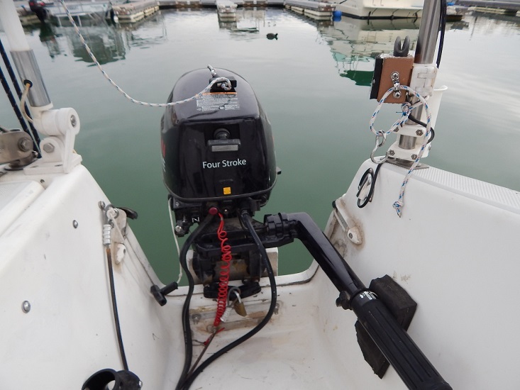

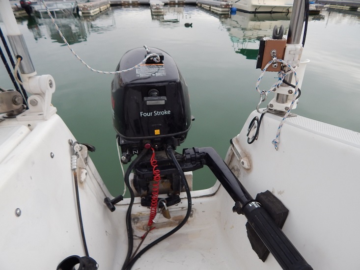

...The biggest complaint I have with the full motor well is that I can't turn the engine much. This really limits slow speed maneuvering ability while in reverse.
When I put the 9.8 Tohatsu in the S's well the same thing. Marginal ability to turn the outboard as shown above.
We bought an extra-long shaft outboard for two reasons. One being that after building the mount shown above the outboard is the same depth in the water as a long shaft model but ....
.... the controls are now higher and closer to the operator. Also the mount moves the outboard aft enough that it will now turn and ...
... with the connector on between the tiller and the outboard's tiller/handle it is real maneuverable.
The mount comes off in a few minutes and there were a couple times on the Bahama trip that I wished I would of pulled it off and had the outboard in the well and lower in the water as the prop came out of the water with the right wave conditions.
More on the mount here ...
