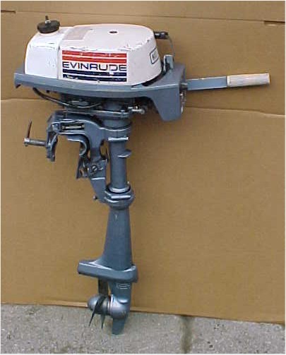

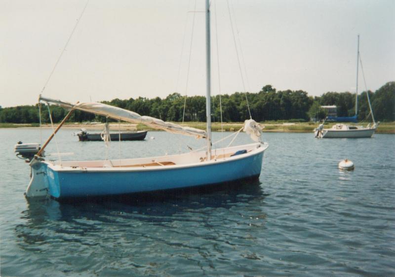

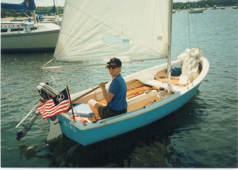

I've included a pic of my boat with the 2 hp Johnson, as well as a pic of a 1973 Evinrude 2. I also added a page from the 1978 Johnson brochure to show the 6hp on a Mariner for rference, as well as the page showing a 4 hp on an O'DAY 12 (also shows the 1978 2hp). The O'DAY 12 was a cat-rigged version of hte Widgeon, but with a different deck.

I notice that you have you motor on a hinge -- how does that work?

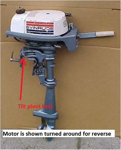

The only "Hinge" on my outboard was the standard tilt pivot on the outboard, I've labeled the pic of an Evinrude 2hp below, not my old OB, but same model. Your 6 hp should tilt up the same, it will come into the boat a bit as it does and with the mainsheet rigged across the stern they may interfere...... depends on just how you boat is presently rigged (O'DAY still used the same basic mainsheet rigging on the 1971 as on my 1969, but later models (and some older ones changed by previous owners) have a rope traveler across the stern and the mainsheet block is either sliding across that or may be tied amidships. If tied amidships it just might be easier to keep it clear of the outboard.

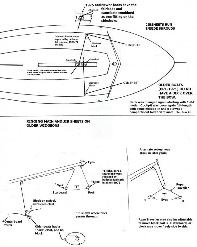

Quick update on my own motor shenanigans, I reported earlier that I have mainsheet traveler mounted to the transom.
I do not, and my memory is not to be trusted.
The Widgeon (at least my year) has two blocks, starboard and port, that the mainsheet feeds through to create a triangle. After test rigging the boat, I don't think the motor will be in the way -- when I test it again I'll take a couple pictures to post here.

That was how the mainsheet on my Widgeon was rigged. The mainsheet could and did get caught on the outboard at times. So, just watch it, and if needed.. guide the mainsheet away from the outboard as you tack. The newer boats with the traveler would be less of a problem (or certainly no more of a problem).

The Engine: Not too big for the transom. It did have a tendency to get in the way of the rope traveler, but nothing dramatic. The motor did not want to stay tilted up out of the water (where it probably would have been much more in the way) and I think the extra drag had a definite impact on performance. Also, I feel like the boat was a little nose up as a result of having so much weight hanging off the back versus within the cockpit.
