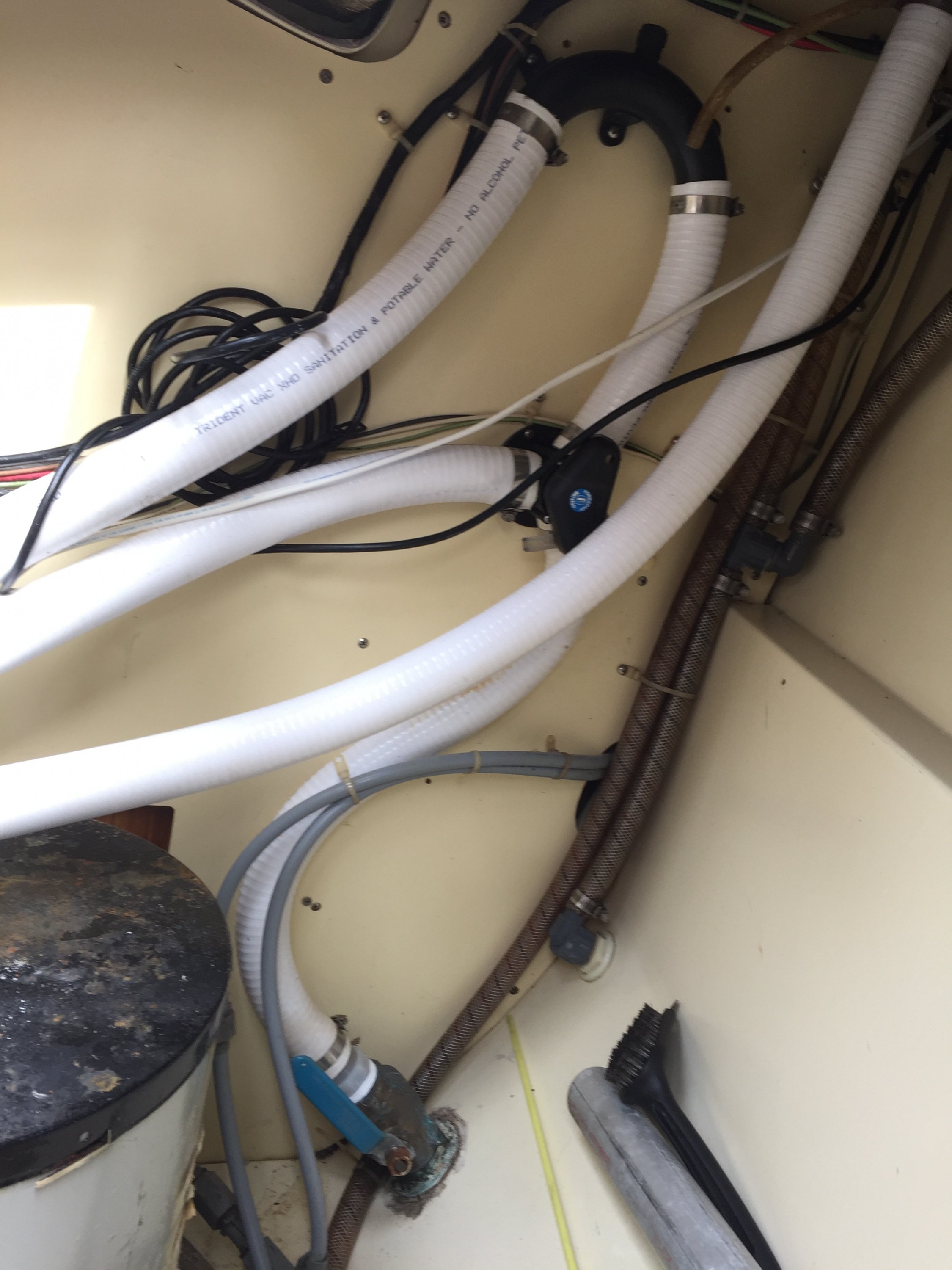

Hi Peggy, First off thanks for responding and sharing that information.
I will attach a photo of my system for a reference and ask for some suggestions. The vertical rise from the toilet output to the top of the loop is 48" ( the hose on the left side of attached image) . Tomorrow I will measure the distance to the waterline but as shown in the photo it is just below the deck line. The "Dry" mode is a new term for me and I will have to read up on that further.
Do you see anything right off in the image that sounds an alarm or that could improve the system ?
My vent line does not have a loop but run from the top of the holding tank along the underside of the deck and vents at the rear of the boat.
Thanks for your help

That's a LOT of hoses coming and going to and from somewhere...I'm gonna need a little help sorting out which does what. We can connect via private message to do that if you like.
It's the toilet's flush water INTAKE that needs a vented loop, not the tank vent line. However, from what you just said, I strongly suspect your tank vent line is a lot longer than the optimal 5'...so we should discuss that too.
As for the "dry" mode...every manual marine toilet has a "wet" or "flush" mode and a "dry" mode. In the wet mode, the pump simultaneously pulls flush water in and pushes bowl contents out. In the "dry" mode, the flow of incoming flush water is blocked...pumping the toilet only pushes bowl contents out, it doesn't bring any flush water in.
Send me a PM...we'll get it all sorted out.
