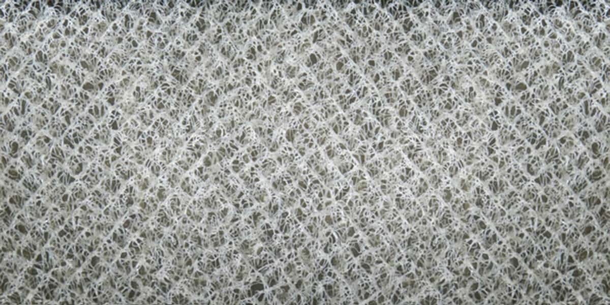

There are a couple of solutions. I purchased the "HyperVent Mattress Pads" for my Vberth. It works great. Solved the issue of condensation under the foam mattress pad for my on my boat.
Easy to install. Pull the pad off the bunk. Lay a sheet down. Cut it to shape. Repeat. Tape the sheets together. Leave an inch on the out side for air to circulate under the mattress. Put the mattress on top, get a couple of pillows and take a nap...

Our experience after 6 months living on board with hypervent is excellent.

Hypervent works well for me, and like js said, easy to install and take out for cleaning.
