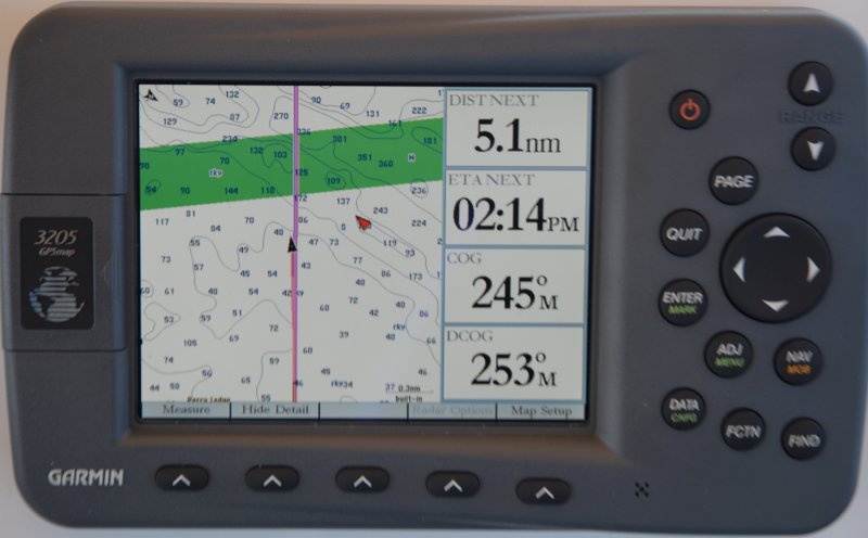

When we do get a vessel on AIS the system can be very SLOW to update the TX ships ACTUAL location. I have actually taken photos of my screen, see below, showing the vessel off my beam when the vessel TXng is now actually off my bow and already well passed me.
In real fog this is an UNSAFE feel good device that could potentially cause real harm if not used in conjunction with radar as a supplement or very carefully tracked during the refresh blips. In order to make the most efficient use of the AIS bandwidth available, vessels that are at anchor, mooring or dock or moving slowly are set to TX on a less frequent basis than those that are moving faster. The AIS refresh rate can range from as long as 3 minutes to as fast as 2 seconds for a fast moving vessel. The big problem is that not all boats are supplying SOG/STW info and you can be often guessing at the refresh rate. AIS class A boats are more accurate relative to what they are doing and tend to give the most information.
AIS needs to be used with respect if using them in an area that gets fog and with the understanding that at this point only some commercial ships and a small handful of pleasure vessels use and TX AIS.
These photos should give you an idea of how inaccurate, compared to radar, AIS can be. We were doing 6 - 6.2 under sail and that boat was moving slightly faster than us but not TXng SOG. Look at my position on the chart at .3 nm range compared to the AIS vessel in red. If this was in fog, and your only device for collision avoidance was AIS, this could be very dangerous if you had not been tracking it for a while or they made a sudden course change. This was in bright sun so no danger and I only wish I had been spinning my dome. I moved less than .1 of a nautical mile when the AIS boat went from photo position #1 to position #2 in a split second refresh rate. Not cool if in pea soup and this is why I don't feel AIS is ready for a prime time "replacement" of radar.
Sorry for the blurry photo.

Hi I don't know too much about AIS except what info gets on this forum but you said you have AIS on the new VHF and are showing it on your Garmin GPS,is that how it works it the VHF radio is wired to the GPS and than show's the AIS ship on your GPS.
I guess in that situation I would have radar on andthan the VHF would be show any ships tx AIS.

Wow very interesting. So I guess AIS plots the position of with a combination of TXed coordinates and dead reckoning using TXed SOG and heading thereafter. In your case that info wasn't available. So instead you have an apparently anchored boat executing hyperspace jumps every update period. I suppose that a smart enough AIS might recognize that, and flag such boats.

I have used AIS extensively since it was first introduced over five years ago. I use a single channel AIS receiver which can result in small delays in target acquisition and have a PC based Nav program (SeaPro) which gives CPA (Closest point of approach) and TCPA (Time to CPA) and displays these on screen. I also have a duplicate setup in my study at home and regularly monitor the two local ports of Southampton and Portsmouth.
Is your Standard Horizon a single or dual channel receiver on AIS?
I have found my system to be very accurate and far better than radar because it calculates the above from the transmitted lat/long of the other vessels and compares it with own vessel's lat/long. Radar's MARPA can only do this from calculations based on the distance moved between scans averaged over several minutes and then only so long as both vessels keep steady courses. (Yachts at sea don't do this).
As far as monitoring Class A transmissions from ships, the display is regularly updated with only small jumps in each vessel's position. Class B on leisure vessels is not good at all because of the lower frequency of transmissions and that the Class B set can only transmit when it can find an unused slot and cannot reserve one in advance. I wonder though if your VHF radio is feeding data to the Garmin as it comes in but that the Garmin is unable to process it fast enough to display on screen and thus misses some of the updates?
The greater majority of leisure vessels do not carry Class B AIS anyway so radar is one's only recourse in thick weather.
Many ships sets cannot decode class B static data so they may see you but have no idea who you are and cannot call you because they do not have your call sign.
If there are more than 25 vessels being tracked then even my PC can have trouble in keeping up with their movements - but it still updates several times each minute. In my area I am often tracking 40 or more ships over a 25 mile radius. This only happens with my rooftop antenna at home because my on board coachroof mounted 'rubber dubber' RIB type antenna only has a range of 10 miles.
International law requires all vessels over 300 GRT and all passenger vessels to operate AIS Class A at all times. If they do not they should be reported to the CG. Naval vessels are excused! I once remarked to the Royal Navy's Fleet Chief of Communications "I wouldn't like to meet a stealth aircraft carrier in mid Channel one foggy night". He replied it was their intention to transmit AIS when not in an 'alert' situation - but I have yet to see evidence of this.

Agree 100% but up here in Maine commercial ships with AIS Class A are far and few between compared to many areas. The real problem in the fog are the vast majority of vessels not TXing any AIS data and pleasure craft that only updates periodically.
I have spoken with both Garmin and Standard Horizon and the delay rate I am seeing is not related to the NEMA speed. If there is any delay it would be in fractions of seconds not measured in minutes as I noted many AIS B boats TXng this summer up into the minutes before refresh..
As I mentioned above it's a good addition, but not yet a replacement for radar as some seem to think it is.
Why do they allow Class A ships to TX at dock when there are only so many "ports" available for the data? I know at a dock they may only be TXng ever three minutes but still once AIS gets more popular the band width, as currently applied, does not seem to support real time tracking when the system gets bogged down?? Thoughts? I really don't care to see a ship at a dock only when they have pulled away..

Well if the system starts jamming up they will probably get smarter about TX'ing. Like only TX if you are 100m or more off your last TX'ed track. Ships at anchor would go silent ships altering course would TX often.

I have not experienced any of the position jumping Maine refers to. I have found that weak signals such as distant class A ones or sometimes class B recreational will sometimes show after the signal is lost and then 'jump' when it gets a fresh signal and tracks it for a while. Perhaps that's what he's experiencing. FWIW, I often track high speed ferries that run in the mid-30's and have not seen anomalies with respect to their transmissions.
