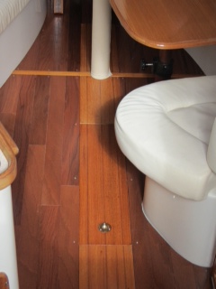

Does anyone know of a good source for teak and holly plywood to fix my cabin sole. I need to patch it and not replace it.

I patched small broken areas with thin sawn maple and teak glued down with epoxy.

A 4X8 sheet of that teak and holly veneered ply costs about $300, I've got one in my basement. It is photosensitive in that when new the thin holly is white and the teak is dark, look at your existing and you'll see it has reversed and holly now darker than teak. I made up some temporary boards of oak flooring that is very tough and decided to stick with them.
