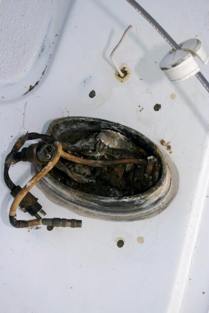

Following mast step thread promted nosing around my compression post area and found water drops coming off a cable that I think goes up to mast head....
this took place during down poor. Previous owner re-cord major portion of cabin top but mad no mention of that area. Can someone explain the construction detail of step area including all penatrations.......cheers frank

Thanks Dave it is very helpfull. What do you think the chances are that some water is finding its way down the mast and following the wire through the conduit wwithout thus bypassing in effect the core? Is it worth while to cut access trim out inspection pannel in said area?.....frank
