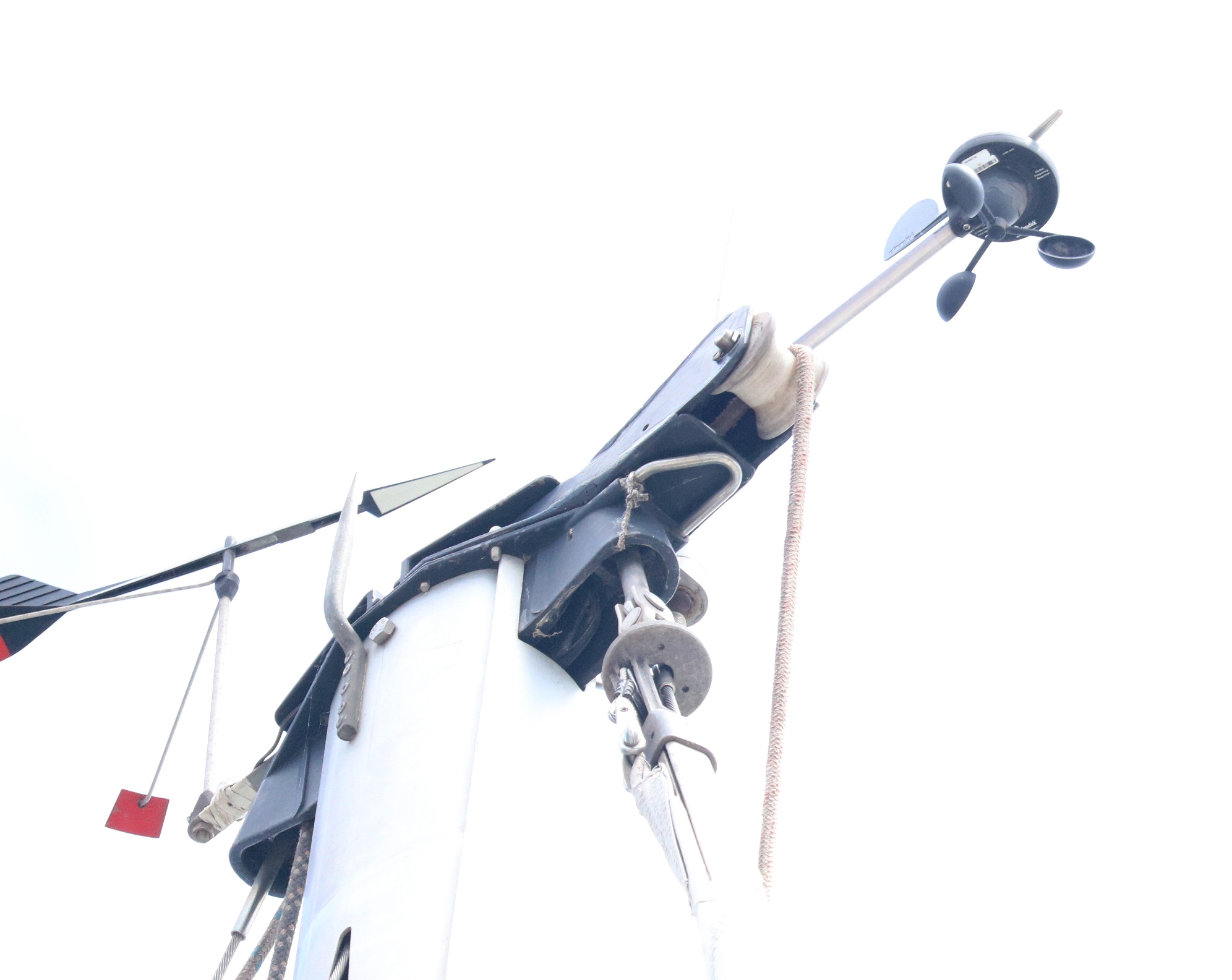

My O’Day 322 has a bit of a mast crane. But the spin halyard uses a roller instead of a block (may change that in the near future. But you can see the relationship between the spin halyard and the jib furler. Note that I have a CDI furler with a built-in wire halyard (so no halyard for the jib at the mast head.
I do pull my spin halyard around the speakers and tie off to a shroud even with the mast when I am not using it.

Greg,
It looks like someone bolted an anchor roller to the top of your masthead. The SS loop that is forward of the jib halyard is a more typical masthead crane for a spin halyard. A swivel block should be shackled to it.

Greg,
Like I said, I intend to deal with the spin halyard this season. Not sure why the PO set it up,that way, but the roller is really hard to pull the halyard over. I looked at it when I was up on the mast to pull my wind instruments down for the winter. It really looks like an anchor roller...no bearings in it as far as I could tell...just a solid bar through it with cotter pins on each end.
Thanks for the validation of what needs to be done.

I second that opinion. It should be replaced. I’d consult a reputable rigger.
