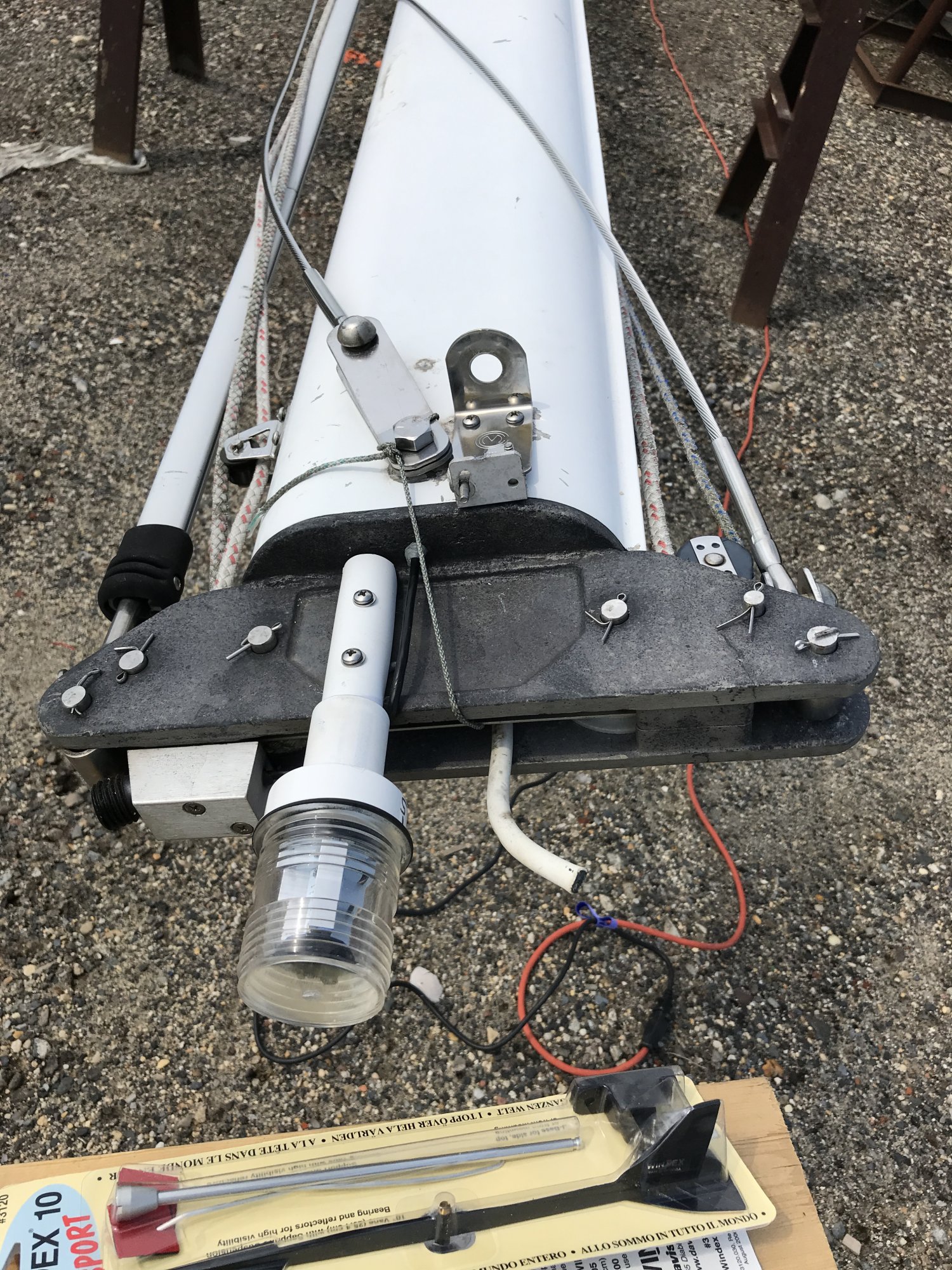

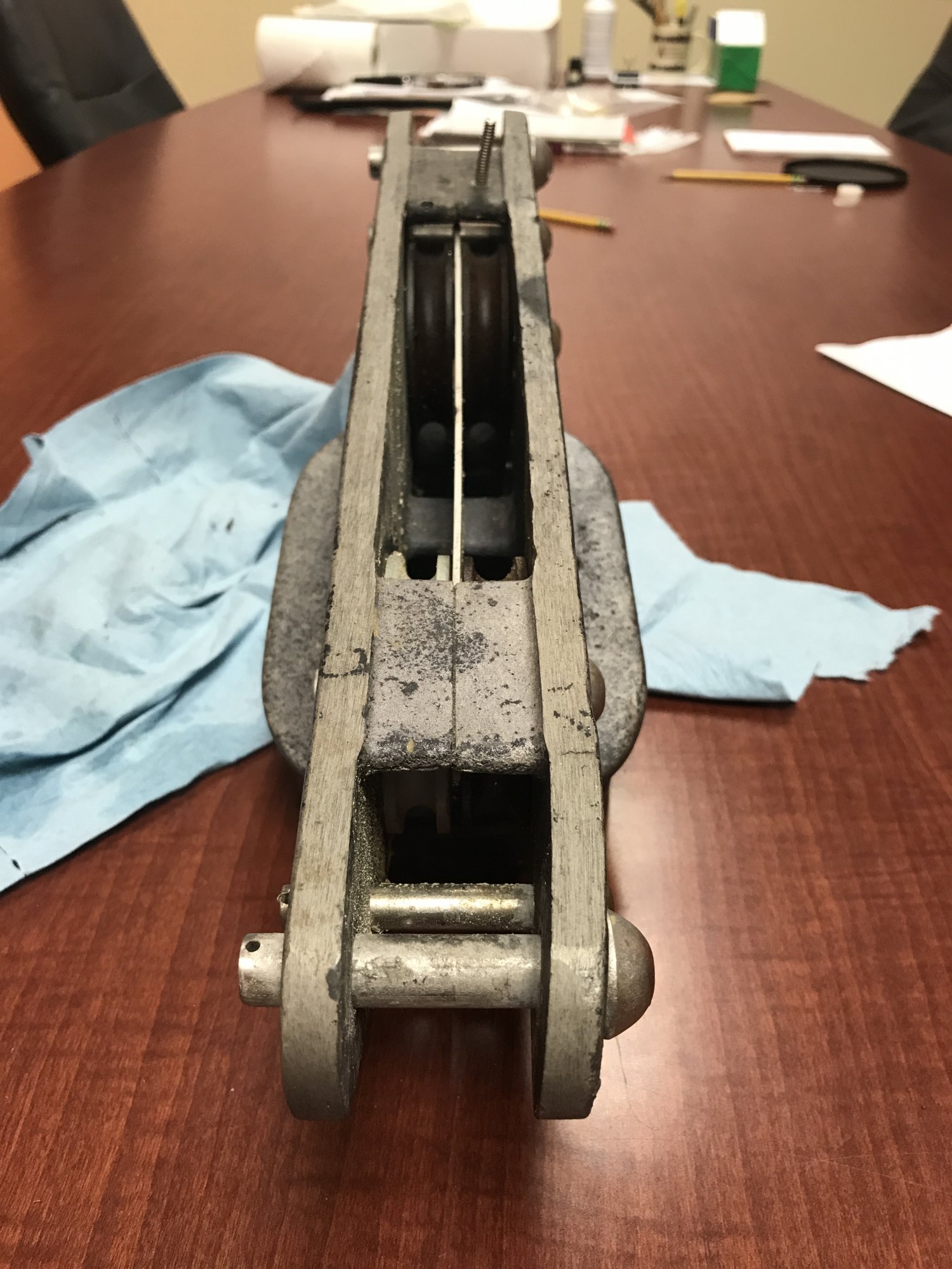

Yep, on my 93 they slide to center then up and out. Here are a couple of photos.

Wow Ward! Thanks for sharing and with pictures too. I have to wait for our lake to drop 3 feet before the crane and rigger can reach the masthead. Nice to know I won’t have to remove the whole rig just to install new sheaves.
Again Thanks,
Mark
