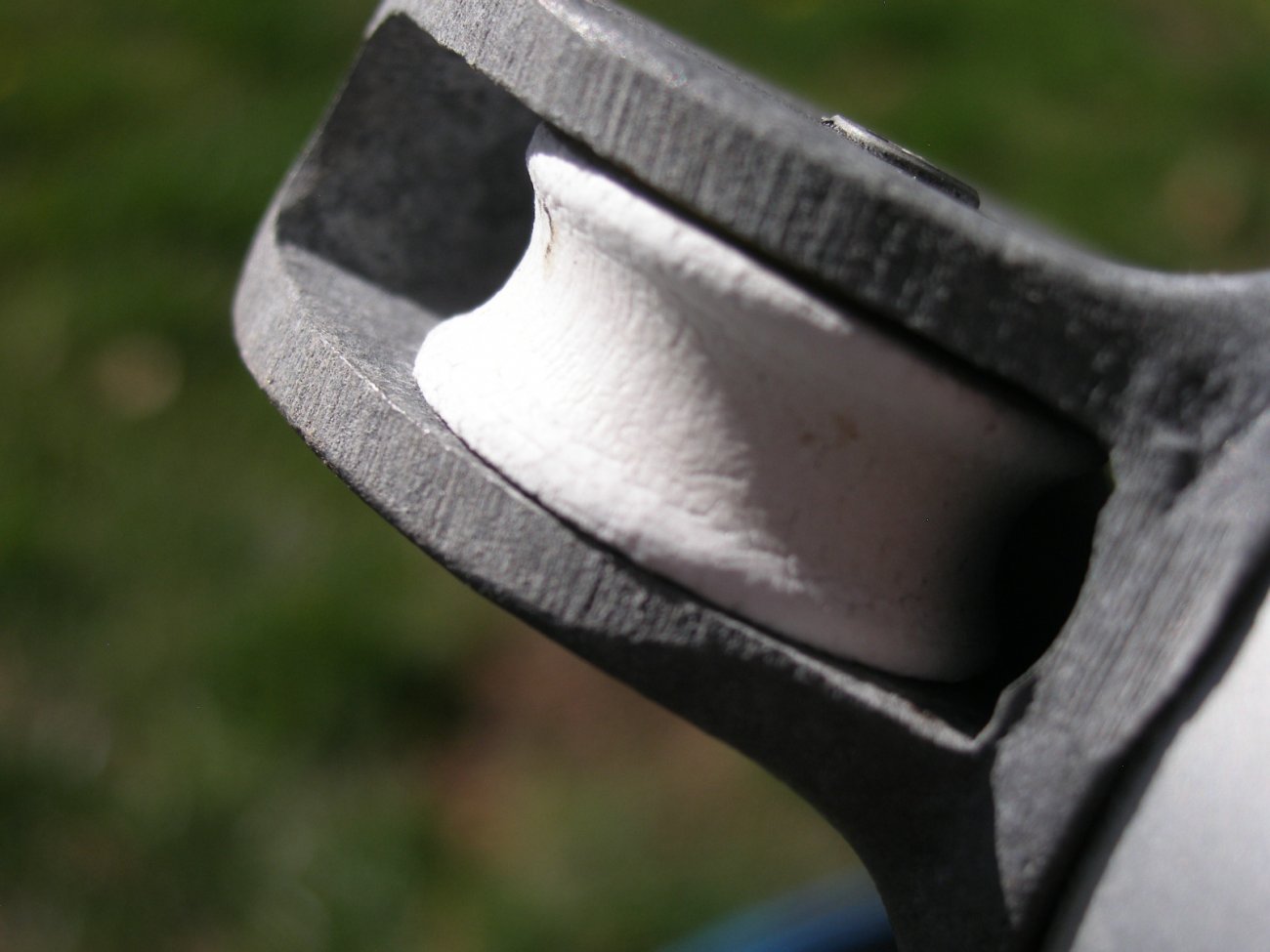

The masthead sheaves are powdery and cracked. I think the picture gives a good view.

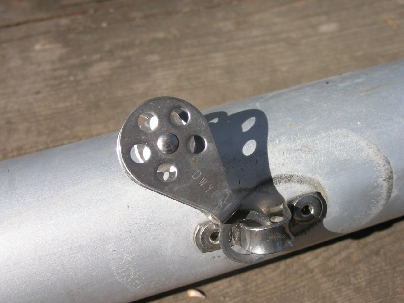

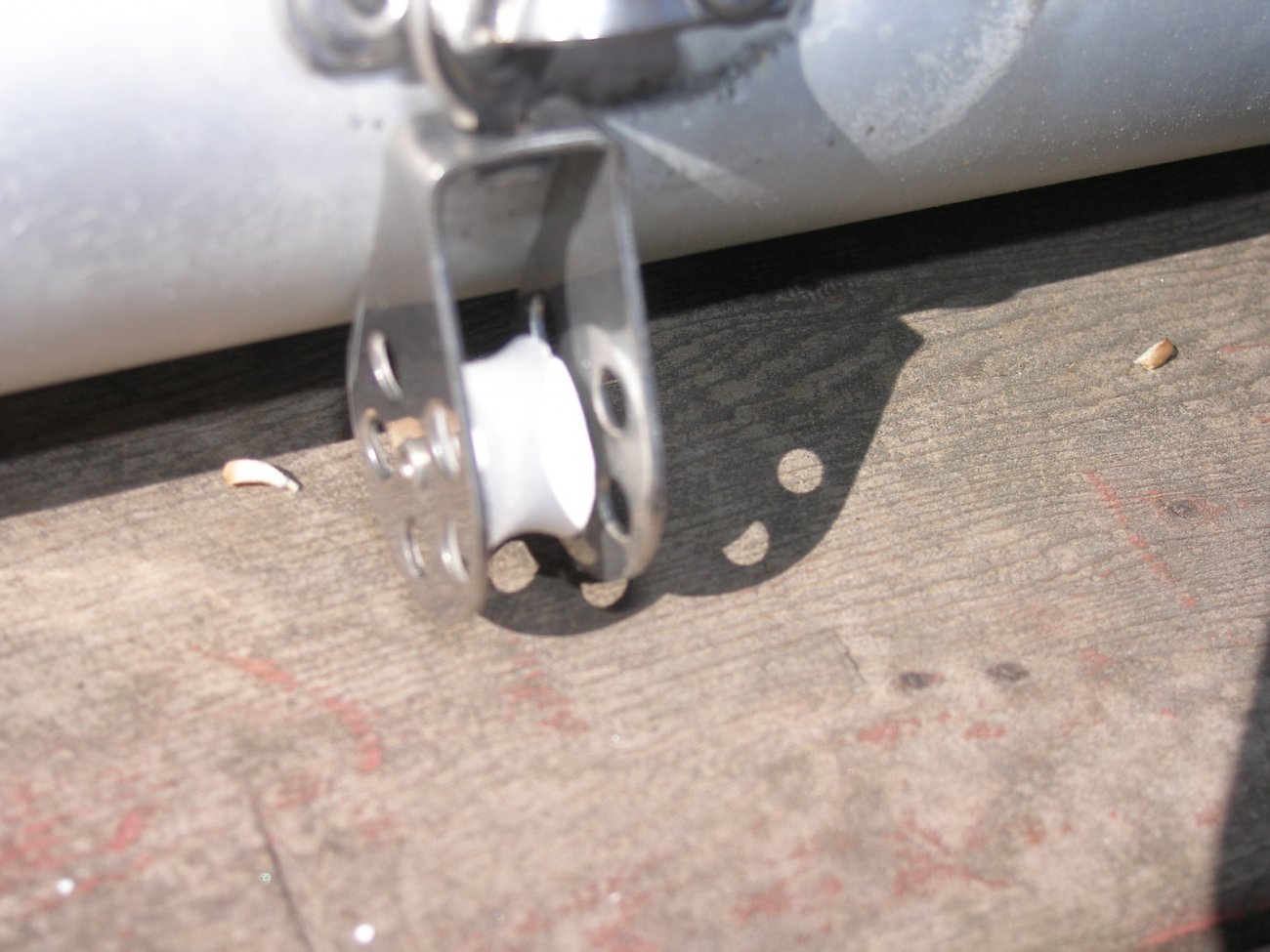

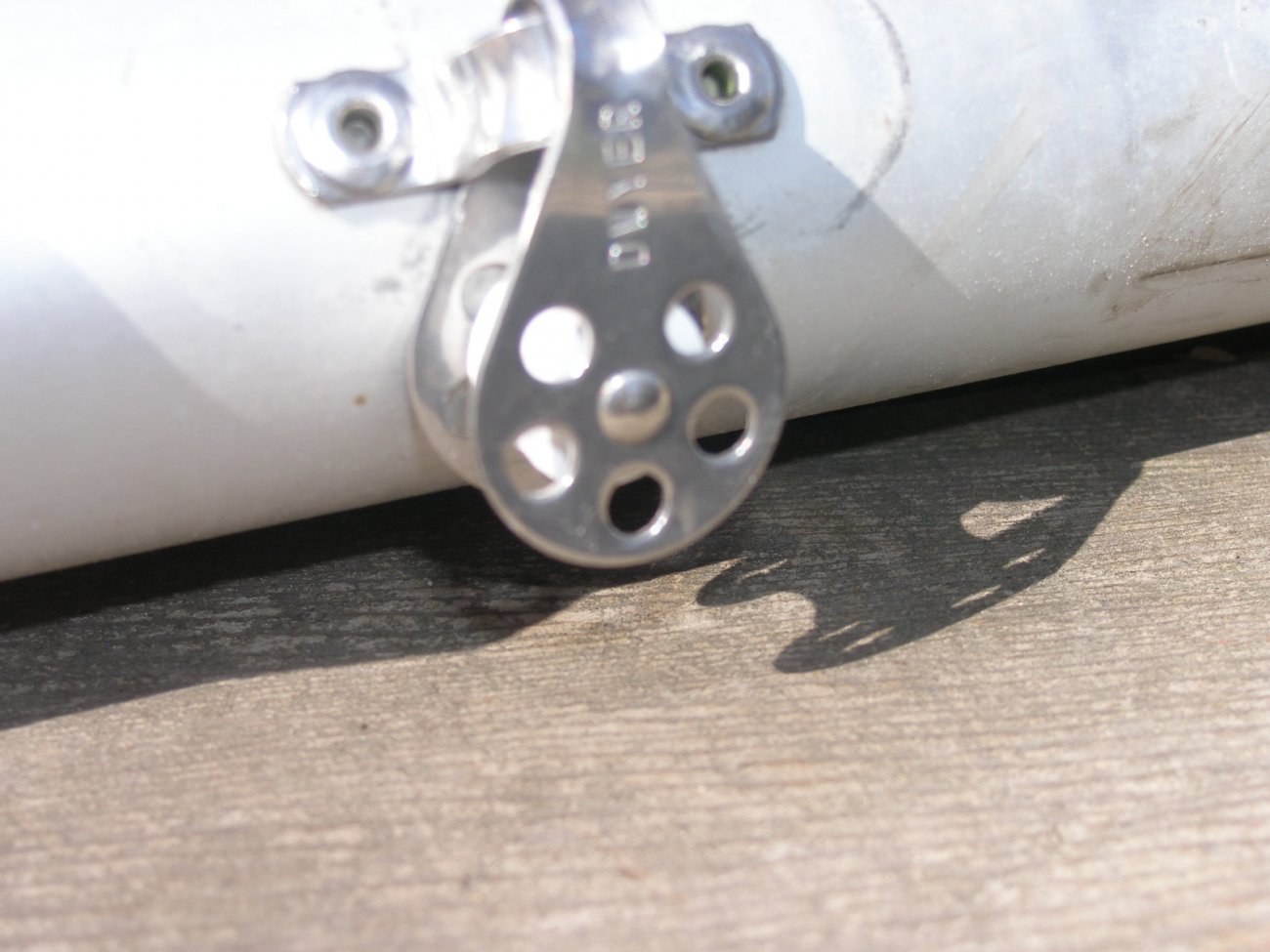

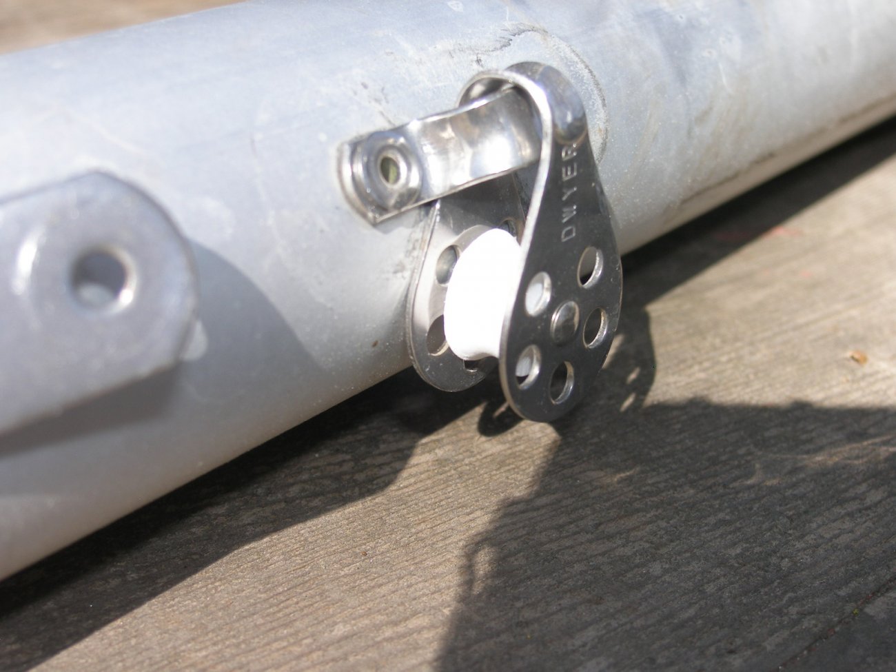

The 2 blocks also look like they are much smaller in diameter then what they should be.
