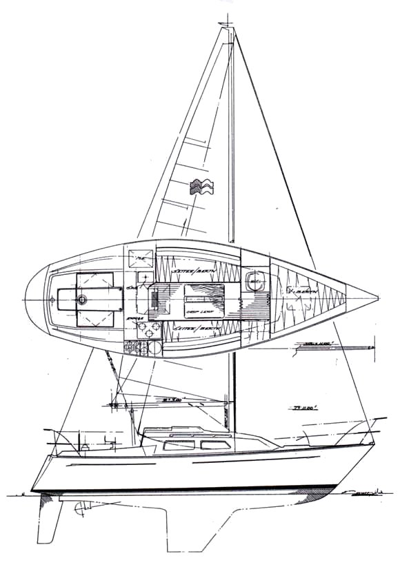

Here's a drawing of my intended victim...
Even just doubling the length of that crane would make lots of room for overlapping roach carried to intersect boom at same angle how much longer would it be?
DArcy

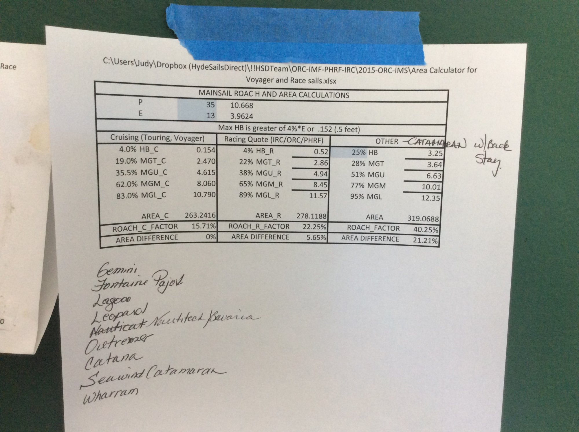

Jun 25, 2004
909
Yes, If the crane you add allows you to fit a mainsail with a head girth that’s 20 to 25% of the foot, then you’re in fathead territory. But consider that you might be limited in your ability to add area by a lack of stiffness of the boat. Without “excess” righting moment to spare, you can’t safely add area at the top of the sailplan. Adding area up high affects heeling much more than area down low. Heeling will definitely load up the helm.
How stiff is the boat? Sailboats with that much area up high in the mainsail tend to have deep bulb keels or be wide-beamed multihull, with oodles of righting moment.
IRC/IMF/ORC/PHRF rules limit the head girth of the main to no more than 4% of the foot.
What is the P of the rig? I’ll run some area calculations for you, with typical roach curves for a cruiser, racer, and fathead mainsail.
But again, what performance are you hoping to improve with the new sailplan?
That's very kind of you to offer but, point is moot. After viewing boat's condition & mooring situation, not going forward with purchase.
