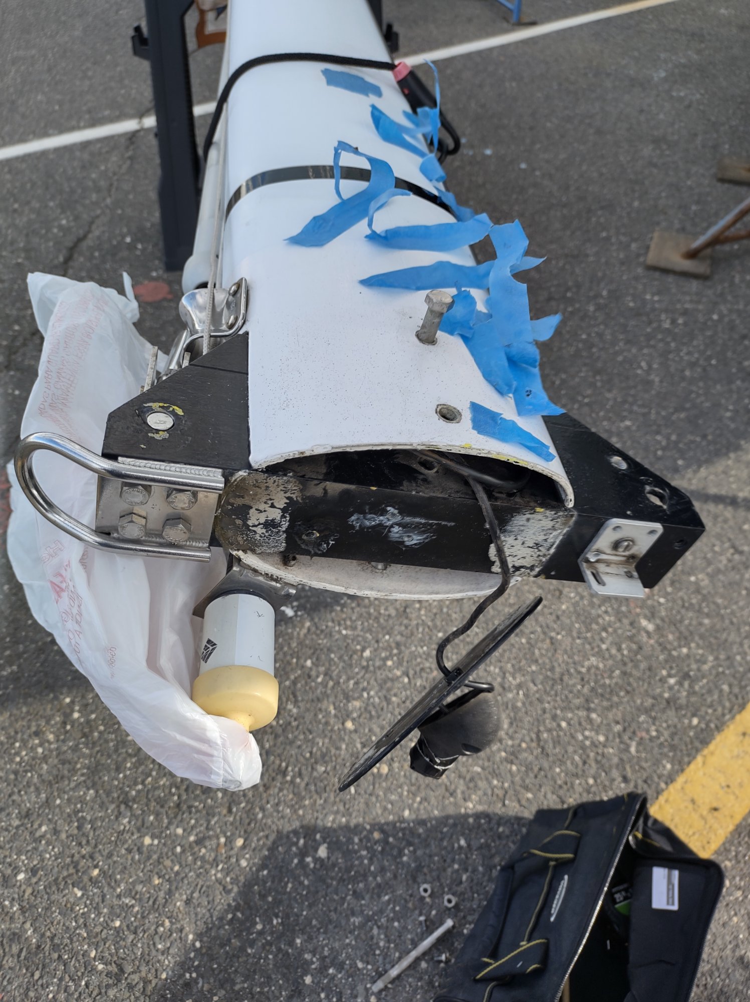

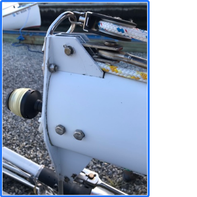

Thanks looks like the right head box

that's a Kenyon mast, probably from the 80's. The two bolts hold the mast head on. very simple if the mast is down.
I'm not sure it could be done with the mast up

Why do you think you need to change the sheaves?
Is the photo in your post #7 your mast head?
That's an easy head to work on - just remove the two bolts that go through the mast and pull that head off. Once you have it off, then the sheaves are right there. You have halyards in place so be careful to keep them in the right place, not twisted or anything. I think that mast head has 4 sheaves in it. Two on the bow side and two on the stern side. Your setup is likely not using all 4.
I'd get my mast set parallel to the ground and high enough so I can spin it so the spreaders don't hit the ground. This might not be necessary, but if once you have it taken apart, it might be nice to be able to spin the mast 180 degrees. Then I'd set up a flat work surface at the head to slide the mast head onto as I pulled it up out of the mast. That way you can pull it up just far enough to work on while keeping all the halyards and wiring nicely aligned. The sheaves are pretty easy to remove.
