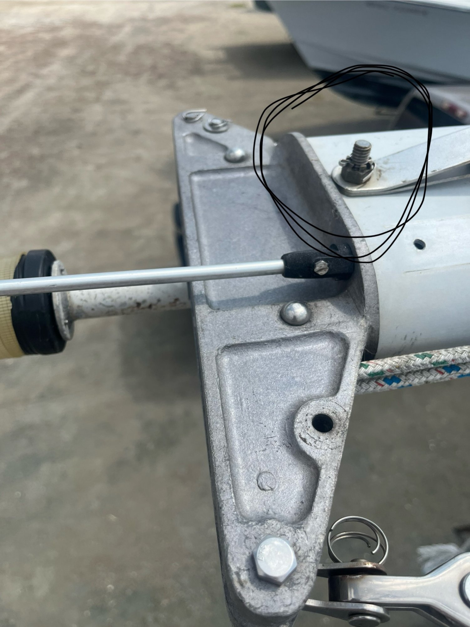

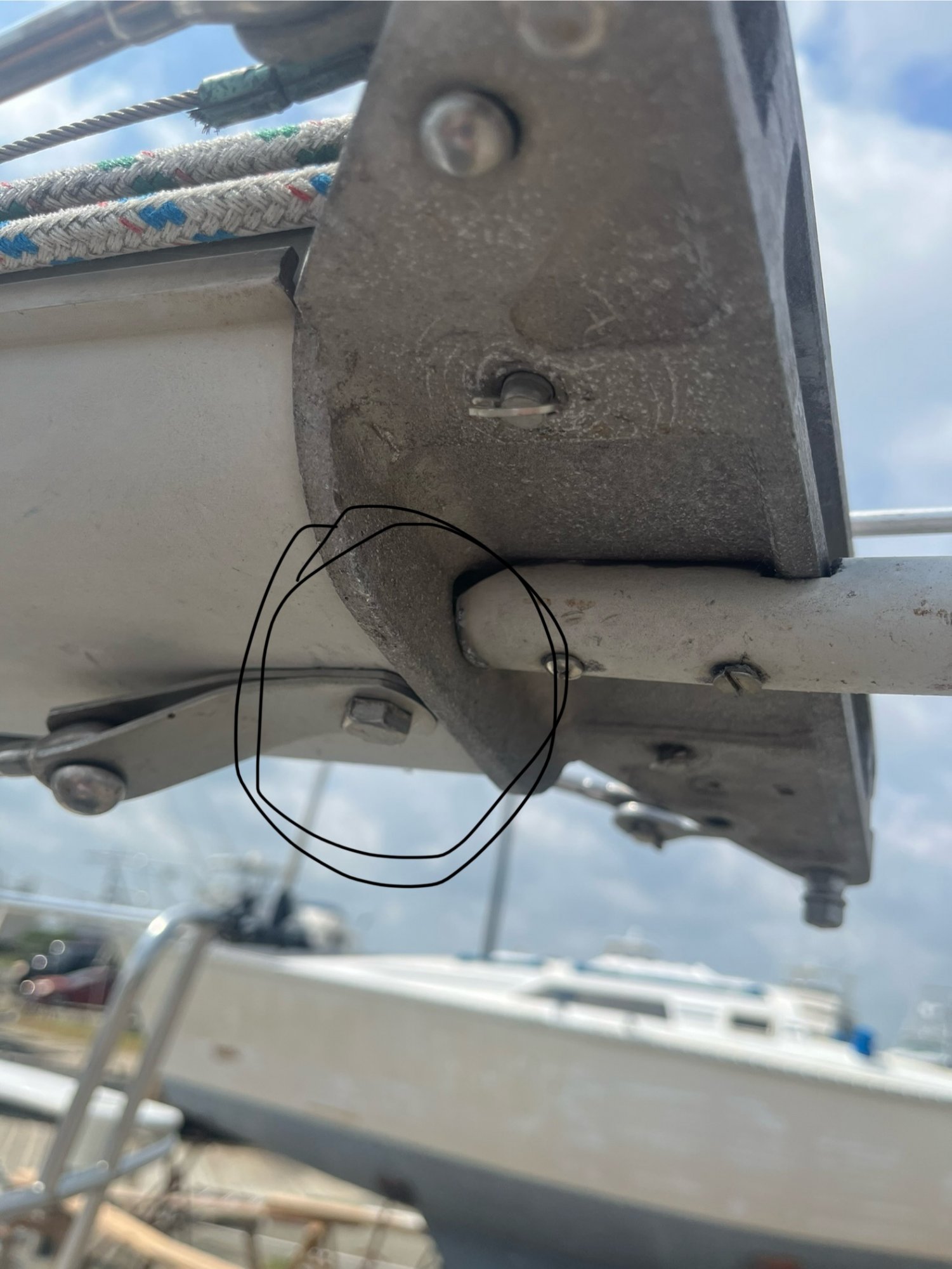

I am preparing to replace my spreader brackets that broke with the kit from Catalina Direct. In order to push a pressure cylinder up into the mast I need to remove the masthead. Is this bolt I have circled the one that will release the masthead? Thank you.

It appears the masthead is held in place with a bolt through it and through the upper rigging cable brackets. Re moving the bolt should allow you to simply pull it off the mast.
