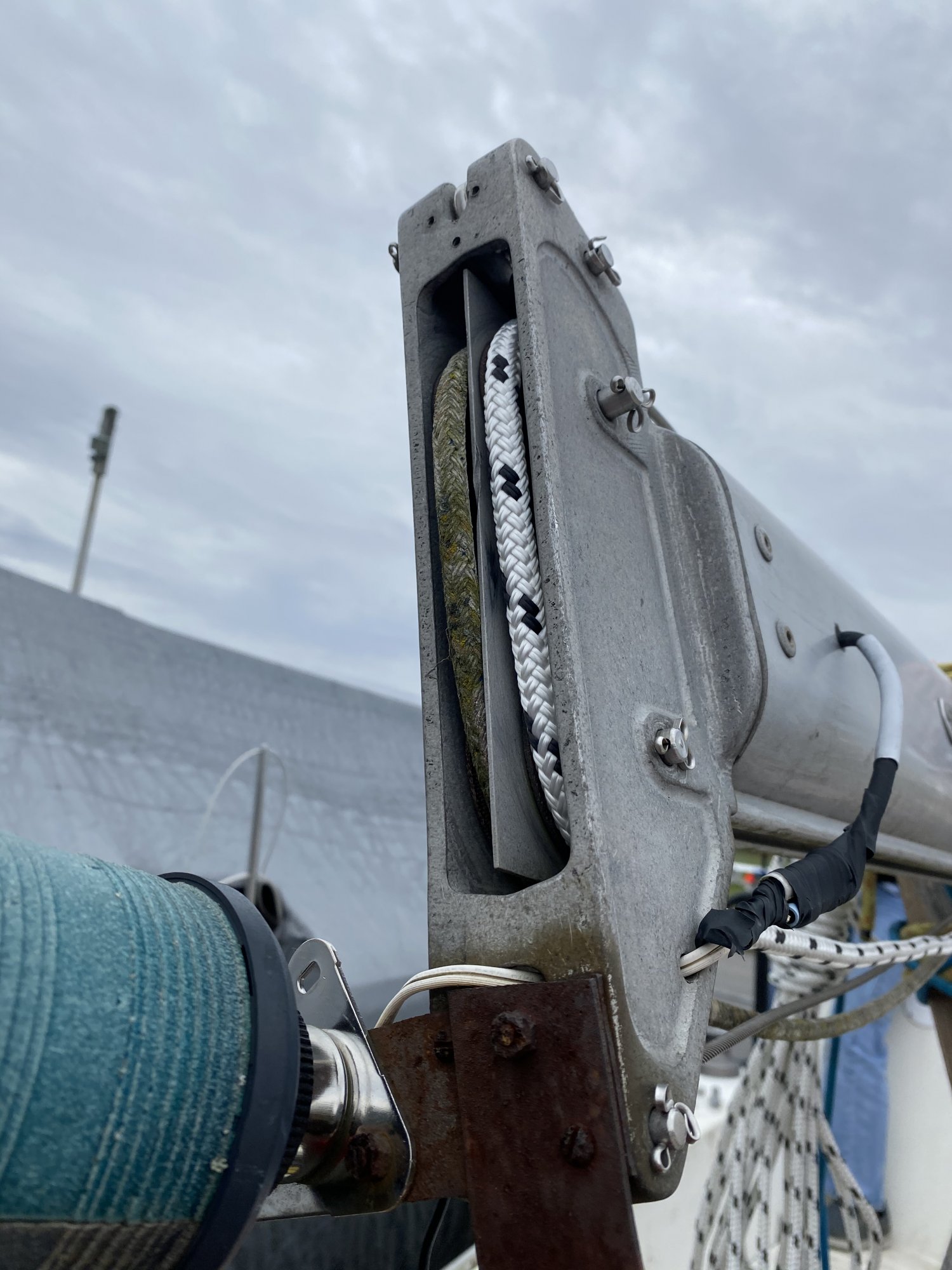

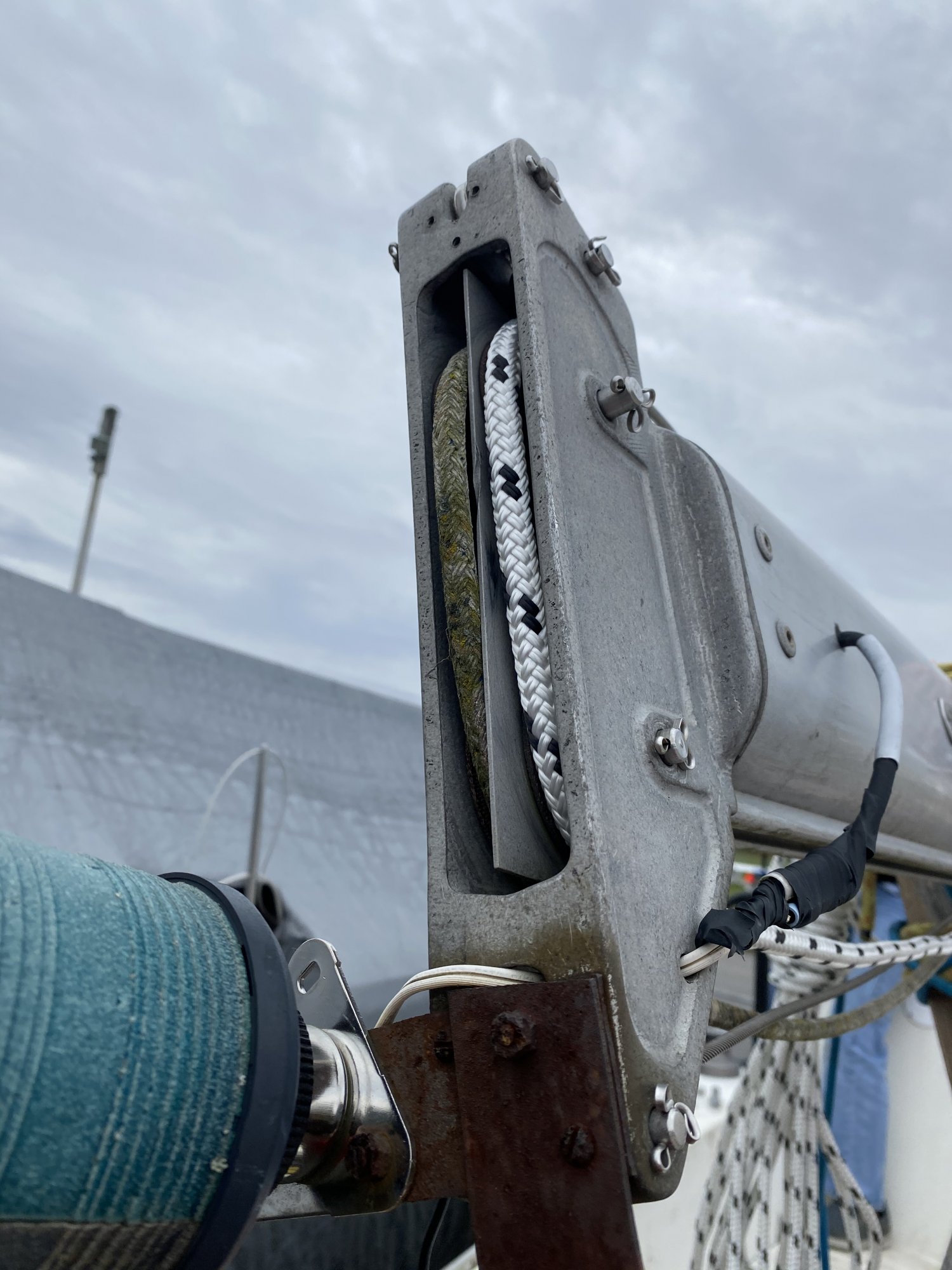

Hey everyone, spring is slowly coming so I’m getting ready to tackle more projects before splashing the boat, my question is how do you fit everything on the masthead?
I have the antenna, the anchor light and windex
For the windex I was thinking about getting the model that fits on the antenna to take up less real estate on top, any ideas on how to get everything on top?
As for the windex what do you think about the model I’m considering? Is it as reliable as a stand alone model?

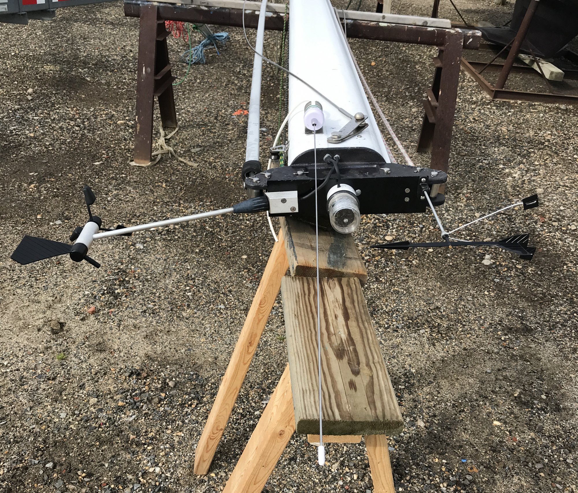

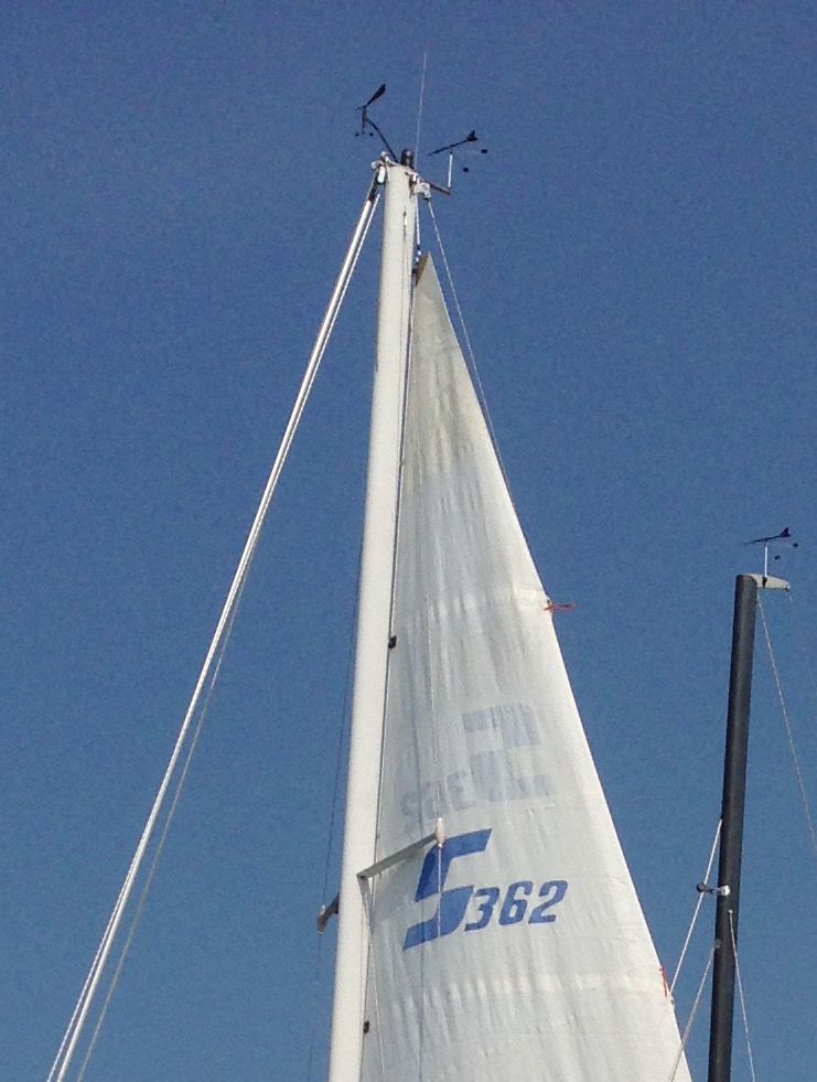

You're right about spring coming; we're getting ready to tap our maples next week. But to refocus on boats... You have a plate attached to what looks like the aft end of the masthead, with the antenna mounted on it. It would make sense to perhaps mount another plate that would cover the opening that lets us see the halyards and perhaps project forward. You could mount the windex and anchor light on that. We have our setup with the AWI and anemometer projecting forward of he mast, the antenna and anchor light directly on top, and the windex aft, so it's easier to see. While you're up there you might want to try rearranging the antenna wire so that it makes a little dip before going into the mast. The way it's set up now, any rainwater that hits the antenna or the wire will be directed down the wire and into the mast. If you make the wire go just a touch below the hole in the mast and then go up into the mast, water will flow down the wire and drip off - and not got down inside the mast. Stay warm in the meantime!

Good tip on the wire, I have to rewire the mast before getting the mast up anyway so I’ll do that as well, the plate which goes aft will be replaced with aluminum, the po used steel and it’s all rusted

Different boat but I did what @PaulK suggested and put a cover plate on the masthead. Allows for more mounting options of the mast top equipment and keeps water out of the mast.
