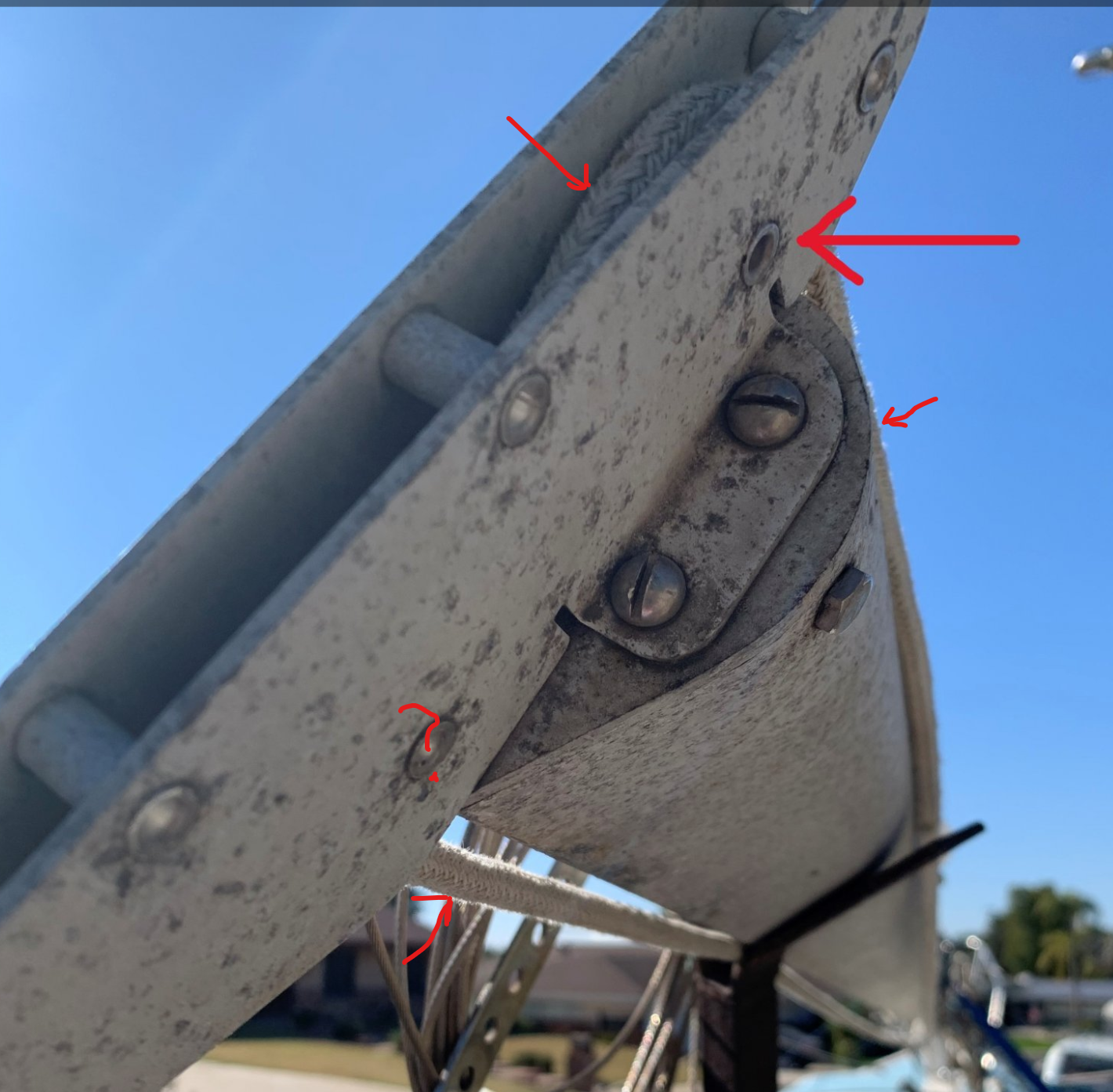

Question
Is the line I'm pointing to all the same line? (Sorry I should have used a different color) If so, the pin where I have my ? - is there a sheave there also? or just a pin? Looks like this line has some funky travel up there in your mast head....

Yes, and Yes. It's your mainsheet. You can remove the masthead fitting and do a thorough inspection and refit, by loosening the tapped fasteners.
Joe's suggestion should come with a warning.... when you remove stainless steel fasteners, that thread into aluminum, in a boat of this age, the corrosion often causes the bolt to snap and then you have a big hassle of drilling out the old fasteners.
You need to slowly work the bolts out, often with some penetrant or even heat. There is a recent thread in the forum's discussing the various options.

Question
djView attachment 202371
Yes, the same line. There is a second sheave but it is further to the left in the picture. It also has some pretty good sun rot and needs to be replaced, but not as bad as the first. Where your mark is, is just a pin. I'll double check the travel as well.
Yeah, looked like there was likely two sheaves in the head for that line. Definitely if you are going through this work, fix 'em all...
I would not be surprised if you have to build, or get built, the replacement sheaves. Have you thought about what material you want to make them out of?

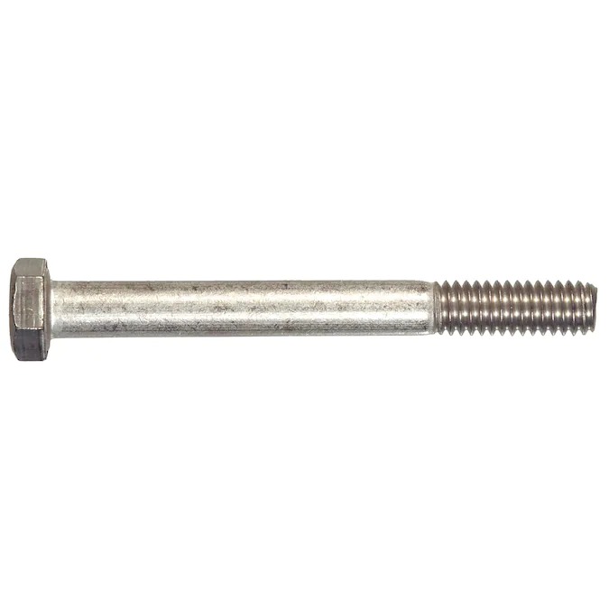

Well, I worked on pulling the for screws to get the masthead off. I was hesitant to pull off the entire cap, not knowing if there were cables or (???) attached within the mast itself, but after trying, and spraying, and waiting, and trying, and spraying and waiting (etc etc) I ended up pulling the top cap bolt and its a good thing (See pic), the screws were welded to the bolts :)
Got it off, and removed the rivets and sheaves. (see pic) Ordered some from the link mentioned, just hoping I ordered the correct ones, if not they have a return policy (LOL).
