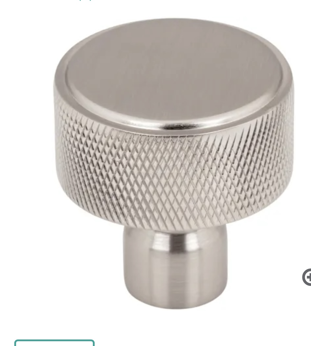

I guess I should have been more precise. I am interested in mast gate locks. This keeps the sales slugs from coming out of the mast.At the master gate

My C30 just used a 1/4-20 bolt and washer threaded into a drill and tapped hole.

Some of the sail stops wont work .
On our boat the boom is quite aways below the slot . Removing the sail stop will allow the slugs to come out when lowering the sail.
The gate would allow the slugs to drop down behind the gate until they bottom out .
Just about any piece of angles aluminum will work
