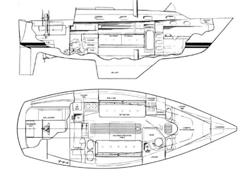

Im trying to verify information obtained thru Google regarding the lenght of the mast of a 1985 Pearson 303. It says 30.3 ft.
Also I need to know the overall height from bottom of the keel to the highest point(I guess the highest point would be, the deck(?)
This is crucial in order to ship her over the road(I'm far away from where she is by 100's of miles)
Your collaboration with this would be appreciated

The P dimension of 34.8 feet is the length from the tack of the mainsail to the max hoist of the main. That's why I think 30.3 ft is short.
Further down from the P and on top of ACCOMMODATIONS says:
MAST HEIGHT FROM(and nothing else after from) that's why I'm asking is "from" from the deck height measured?

I need these measures 'cause the trailer transport company needs them. Hey thx a bunch for your help man.. I do... Appreciate it

DWL is designed water line, so your masthead height from DWL is 44.25 ft - also known as your air draft..
