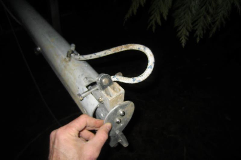

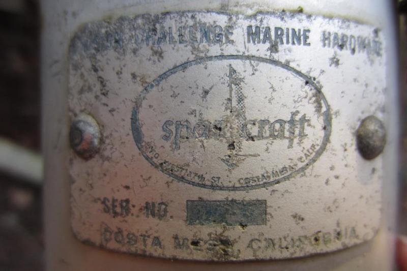

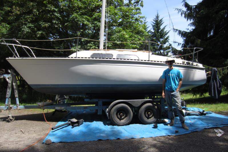

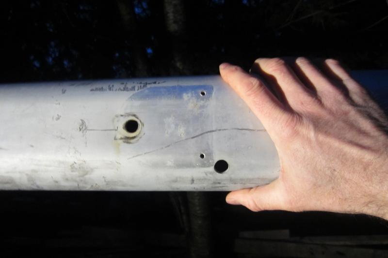

I have a Paceship 23 (although this question is universal).
1) Mast Reduction?: The mast isn't original to the boat and I'm concerned about "fit" and other finer points. I'm getting close to determining exact original measurements, but for our purposes here, let's say the mast is about 2-3' taller than original. It may also be generally heftier.
PROS = a) easier stepping, b) less weight above, c) I'm actively re-rigging anyway (so now's the time), d) I believe (although may be my imagination) the boat is affected by this weight, d) aesthetics of original mainsail's fit on the mast.
CONS = a) Potential damage, b) having to reconfigure so mast fittings (e.g. spreader brackets, etc.)
Question #1 - should I be considering cutting the mast to original PY23 specs. or is this unwarranted/unnecessary effort?
2) Mast Step: For some reason the mast step was moved forward 6-8" from original position. Now all 5 shrouds (back,lowers,uppers), except of course the forestay, are abaft the mast.
Question 2: Should the shrouds run parallel to the mast and not be abaft the mast's centerline? Am I putting too much tension on the forestay in the current configuration?
3) Mast head: Finally, (you all are a patient and generous bunch if you've read this far). The masthead cap doesn't cover/enclose the top of the mast. It's essentially "open" so that rain and everything else that drops from the sky can get into the mast.
Question: Is it imperative to have a watertight cap on the masthead or are some masts just open to the elements? All of the pictures I see on the web are of closed caps.
Here are some pictures to help with the descriptions above. Any sage advice most welcomed. Thank you.
