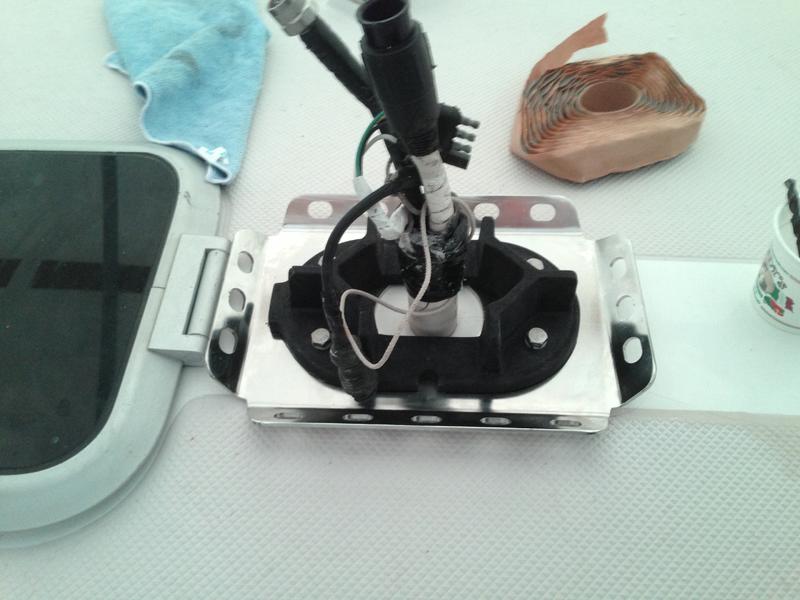

The mast wiring goes through the deck and down the compression post and out through the bilge. You can follow the wires back to the DP. When was the last time you stepped your mast? All the connections are at the base of the mast inside. Some have cut an access plate in the side of the mast to make it easier to access them. Others have rerouted them to a bus bar somewhere in the head. more often than not it's a ground problem.

I'm going to put up a radar without taking
down the mast. Has anybody run their
radar or other wires out the bottom of the
mast and through the deck?
Any recommendations?
