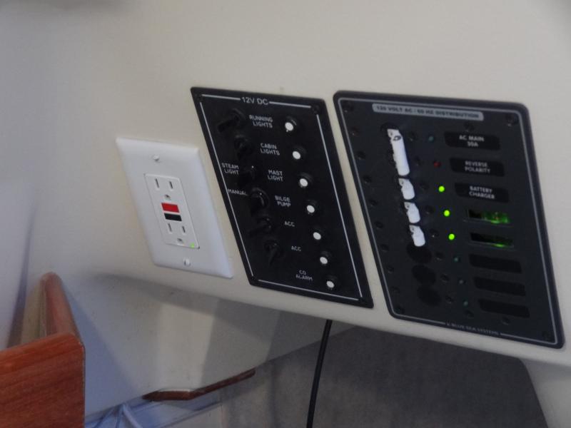

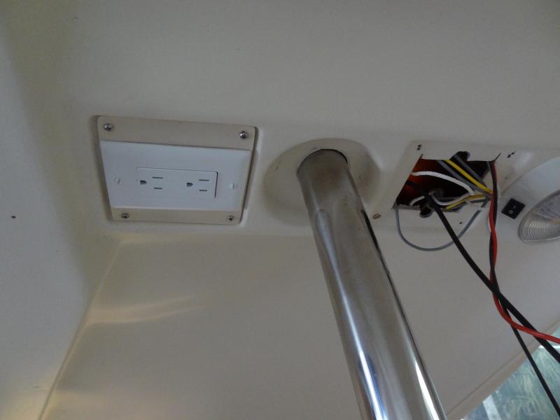

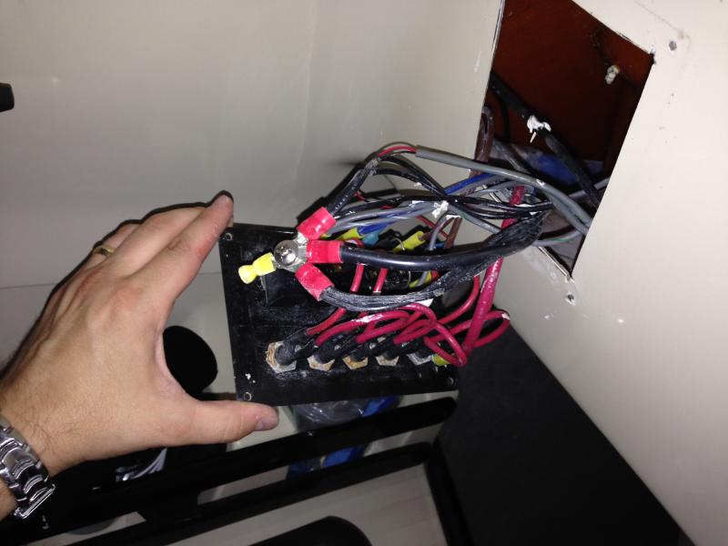

Regarding your question, there is an empty conduit from the fuse box area directly to the ceiling under the mast, where the compression post of the mast is. Look at the pictures.
The first shows the conduit. There is also a small rope provided to pull cable with through. The other end is right beside the galley port, you can reach it from the fuse box area with your hand to get the cable to the fuse box switches.
Make sure you add another rope to the cable when pulling through to get the original rope back in place for the case you want to use it again.
There is another useful conduit going from the fuse box to the aft, behind the aft berth wall, where the battery is. Here is also a pull rope provided.

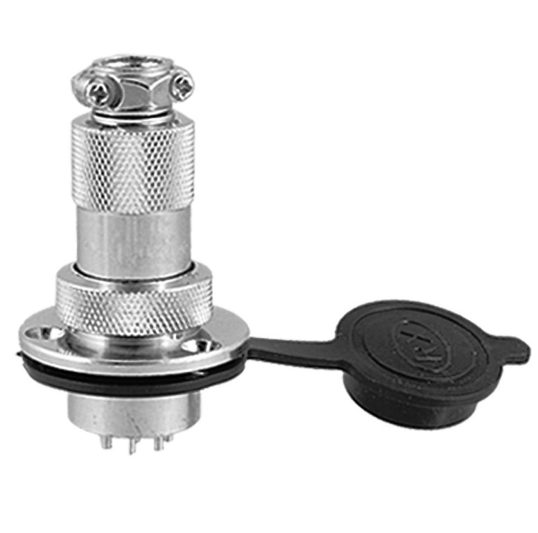

Also I am rewiring the mast; going to install on the top a tri-color- and anchor light. A little down the mast I will put a fixture for steaming light combined with a deck light. That makes 5 wire. I am going to use a 6-prong deck-through connector (they run out on the 5-prong). The connector takes a 10A/250V load. The contact have to be soldered; I am fine with that.

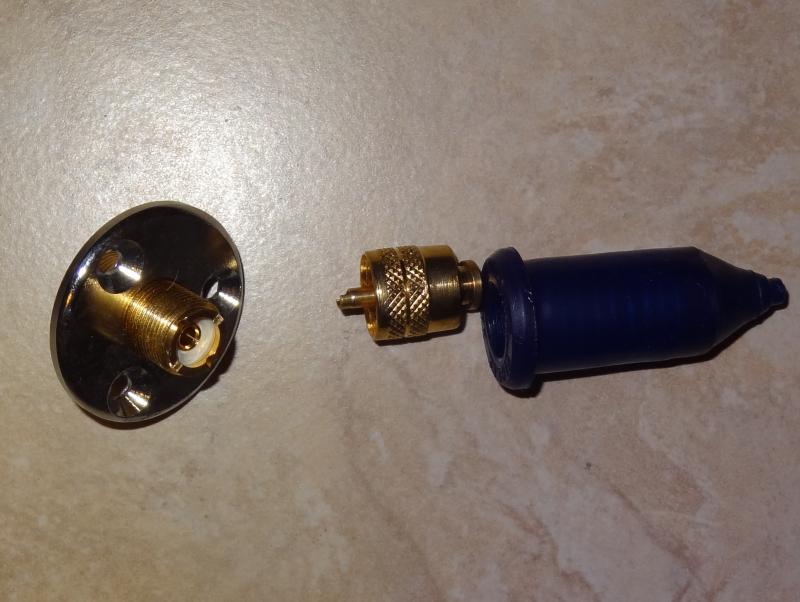

Also I am going to put an antenna on top of the mast for an VHF radio and wired a coax cable to the ceiling. For the cable-deck-through I found a good solution, a connector from C-Me Marine. Will see how it works out.

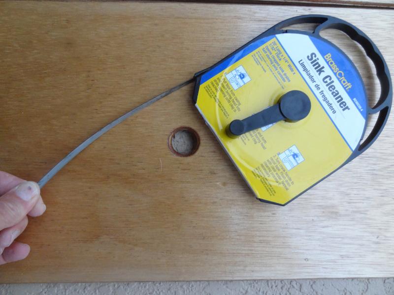

Additional I put two 110V outlets in the boat, one under the ceiling. I did not want to put the 3x14 marine cable with into the 12V conduit. It was no problem the get the wire separately all the way through to the fuse box. Just use one of this steel or fiberglass fish tapes.

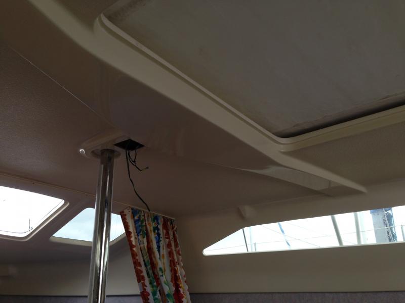

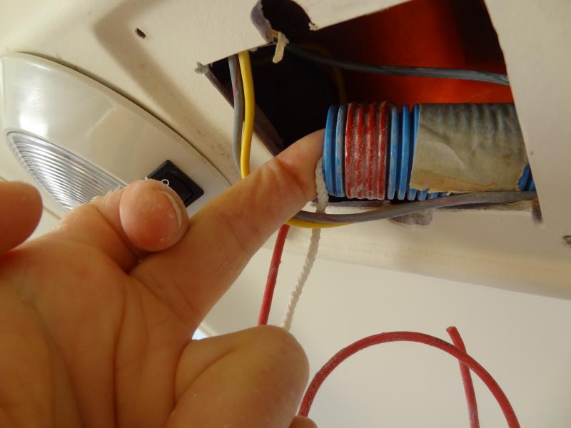

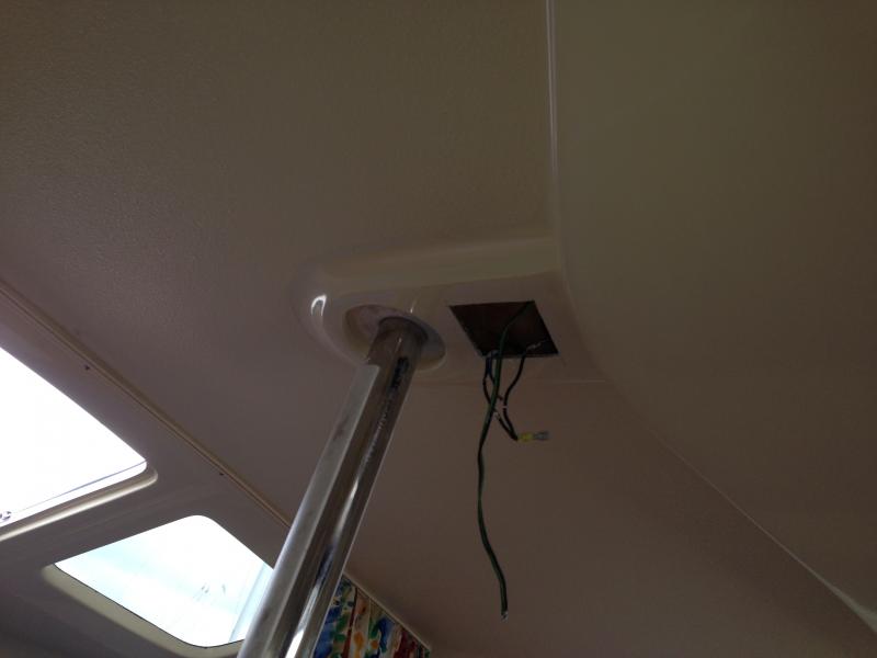

Well, I have spent the last 1.5 years on other projects (or sailing!!:)) in my time on the boat and have not anchored at night, so did not complete this project - but now I'm going to get it done. I have 5-conductor boat cable through the mast (in case of future upgrades - will be useful) and the new deck connection ready to go, but I'm stuck inside the cabin.
As Dave Condon noted, my 1994 H26 is different from the 260 in some respects. In the first photo, the cabin light wires are blue/black and mast wires are longer green/black. In my case, the mast wires do come through blue flexible wiring conduit in the area under the mast deck connection (1st photo - but you can't see the conduit because it's too short), like Regular Guy. However, there is no tracer line - just wires. Also, the conduit is plugged with some very firm sealant such that I think I might destroy the existing wires if I try to dig them out, and it is pretty tight so I can't pull it out much to work on it. I cut the ~3" x 3" hole you see and don't want to go much bigger and not sure it would help anyway.
I have a fiberglass wire pulling set and tried getting through that ~ reinforced athwartships channel you see (2nd photo) and could not. Despite a lot of gyrations, it stops there whether I tried to get through from fwd to aft or aft to fwd.
Options: (1) I might try again to free the existing wires from the conduit, or drill a hole in the cabin roof further to starboard to get at the conduit in another location. I think that would be only guessing at success and guessing the conduit runs the whole way, and it would be heartbreaking if existing wires break while pulling the new larger wire. (2) I think I'm going to need Dave to explain where he drilled his holes - then I could do it once and with confidence.
Recommendations greatly appreciated. I'll submit owner mod photos when complete.

Try to get all the way from the fuse box to the compression post with your fishing tape. I did not get the coax from the mast and a ticker two wire cable for a 12V outlet through the conduit and pulled it separately through the roof. I had to open some access caps for the jib clam cleats on the ceiling and one mid ship on the starboard site to get the the fishing tape pulled through partly. But it finally worked out. Good luck,
