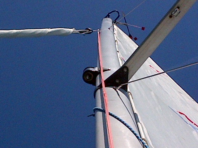

I found a picture of my 'steaming light'. It is forward facing (I just replaced the bulb with an LED) and it sits just above the spreaders. It also has a deck light at the bottom of it that does not have a bulb in it.

That does complicate the equation a bit - testing resistance would still give a bit of an idea what is happening in the mast wiring. You could also try disconnecting the mast at the deck fitting and using jumpers to see what wire is doing what. You may have a missing 4th wire as well since this is obviously not the factory original set up.

The steaming light half way up the mast is an add on as Hunter did not offer that as an accessory. Here is what I would do. I would identify the two positive wires from the light on top of the mast, combine them and attach to the correct post for anchor light. Then I would take the positive to the add on steaming light to the other post. Since you have the four prong deck light plug, see it the wires to the deck plug have four lead wires and if so, run the negative for the new steaming light separately as I do not know what the draw is. Run the negative for the designated anchor light of course combined. Aagain that is assuming there are four wires leading to the deck light plug. If not, you will have to combine all the negative wires together somehow
