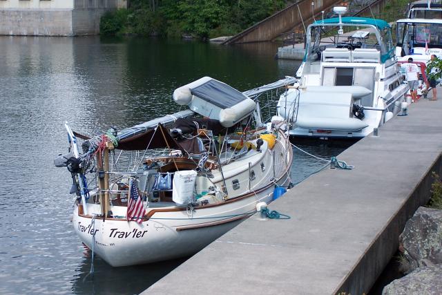

Despite a nice offer for help in Buffalo, I would wait to drop your mast until you get to Oswego where you enter the canal system. Traveling a large lake like Ontario with a mast on deck can be dangerous and you know, from where you sail, how quickly the Great Lakes can kick up. You don't want to get caught out in building seas with a mast the size of yours strapped on deck. I would use two saw horses for a 44 using the bow and stern pulpits, too. Consider blocking the mast up a bit to get it out of your way as much as possible. When I did this I used a lot of line to not only lash the mast down snuggly, but also to lash horses and braces solidly to the deck and puplpits. You need to anticipate power boat wakes you will encounter so the mast has got to be well secured.
Consider a stop at Olcott Yacht Club. We are located about 25 miles east of the Wellend and 90 some miles from Oswego to the east.
The photo is my Nassau 34 as she was entering the Trent Severn Canal in port Severn, Ontario. I have a substantial boom gallows and also used a saw horse to support the mast. One thing I learned, luckily with no mishap, is that when docking, it is easy to forget about your mast hanging off the stern. As you swing the stern dockside, you often look down and back to check your stern clearance. It is easy to forget that above your head is a mast hanging a few feet beyond your stern.
