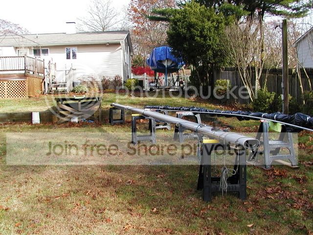

Just curious on what's the best way to prepare the mast for winter storage.
My mast is laying across a couple of saw horses, all the standing & running rigging is still attached. Come January it will be under snow. Should one strip the rigging & spreaders to prevent the effects of water freezing?

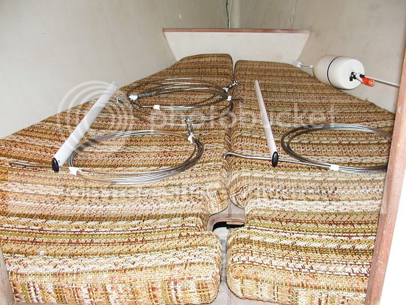

Most usually remove the spreaders and pull the rigging against the side of the mast. Using a long piece of small diameter line bind the rigging to the side of the mast. I like to tape a plastic bag over the furler and remove all masthead adornments. This has worked for me for many years. If you are concerned about snow and ice you can use that packing plastic that is sort of like saran wrap and wrap your entire mast with it.

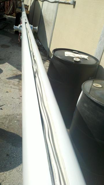

Same issue here. Two more trips to the lake and the painting will be done. Then how to cover for the winter? My spreaders and rigging are all off the mast. Having the wire against the mast and then moving it around is, I think, the reason my mast was so scarred. Our marina wraps the masts for storage in large sheets of plastic. I am thinking 2 mil plastic painter's tarps will work. If the new wire was on the mast I would wrap twice, once under the wire and again over the whole works.
