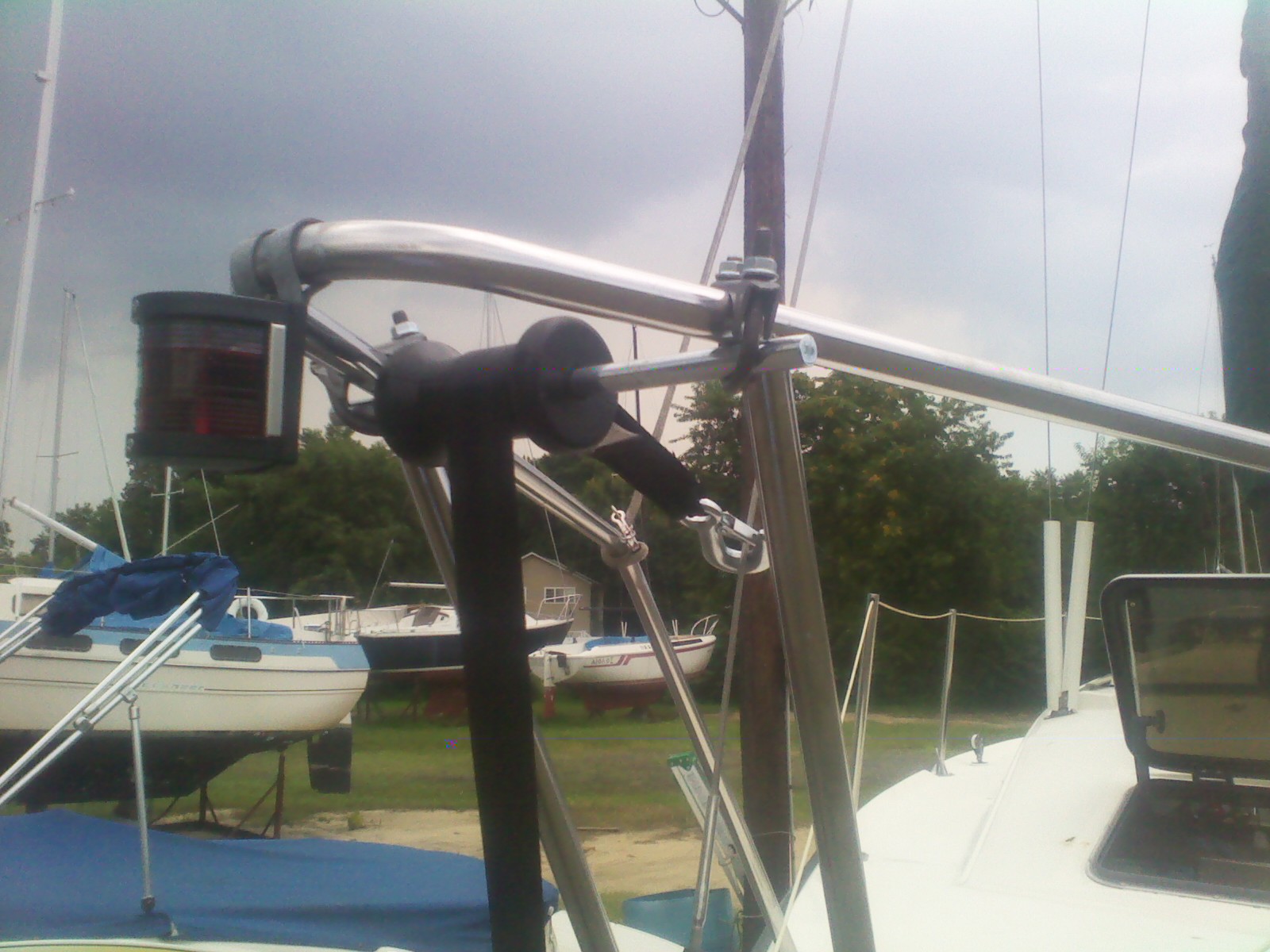

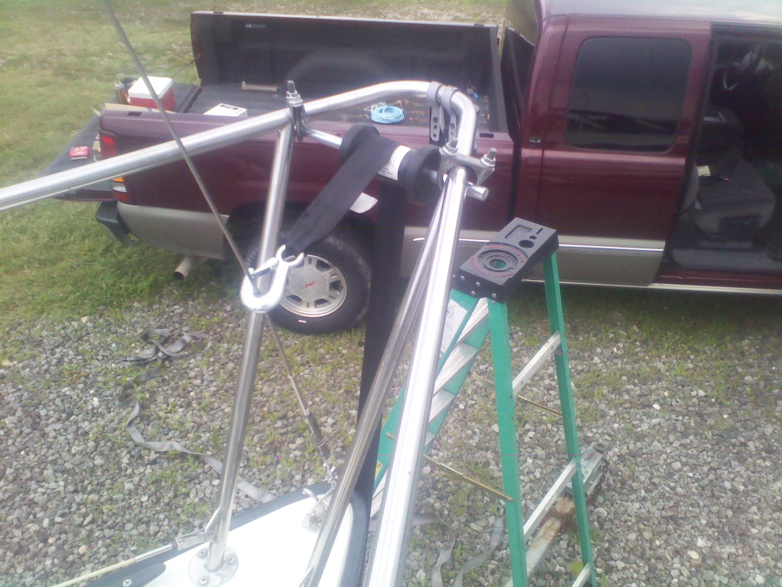

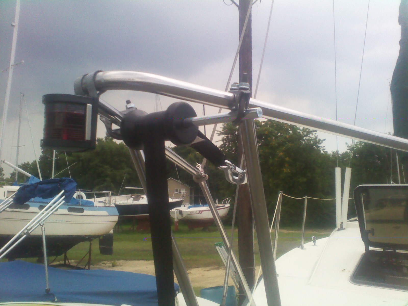

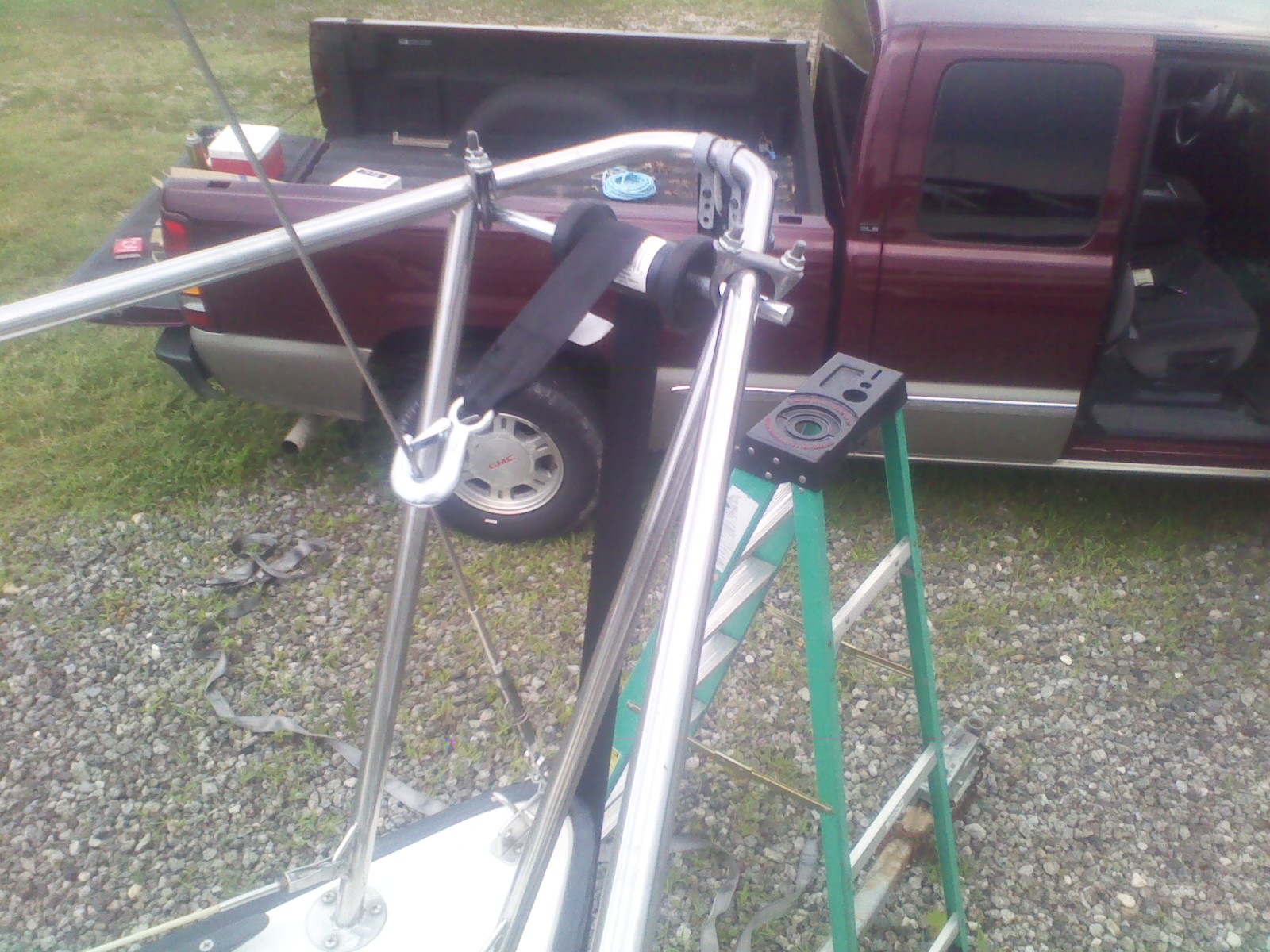

Bow roller 1.jpg bow roller 2.jpg Trailer strap over the roller to the jib halyard is a big help to me.

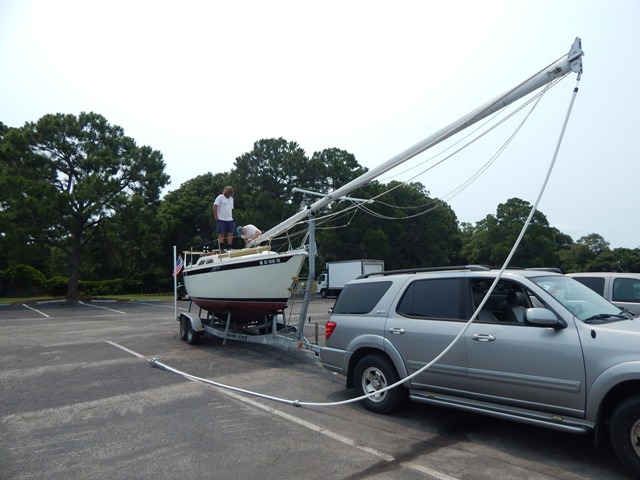

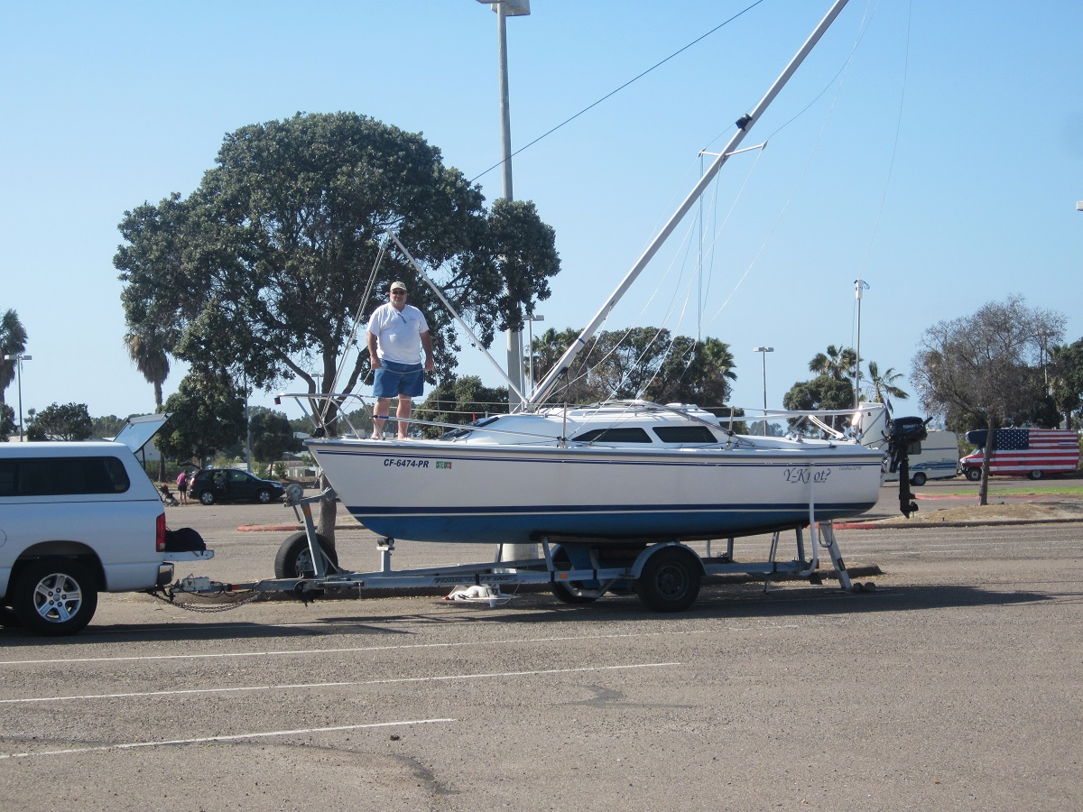

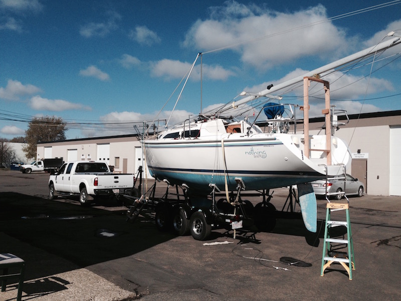

The Catalina factory mast raising system allows us to continue our trailer-sailor lifestyle as we got older, and have some physical limitations. Simple, and effortlessly allows me to raise the mast, and engineered by the factory so the system is strong and safe. If a stay snags on something, I can stop the process at any point and clear the problem, then continue raising the mast.

What is pictured is not specific to any boat at all. It's the same setup on a whole bunch of different ones, and as long as you have a tabernacle that the base of the mast can rotate on, you can make it work. I use exactly the same setup on the 270 and it has a 32' mast.

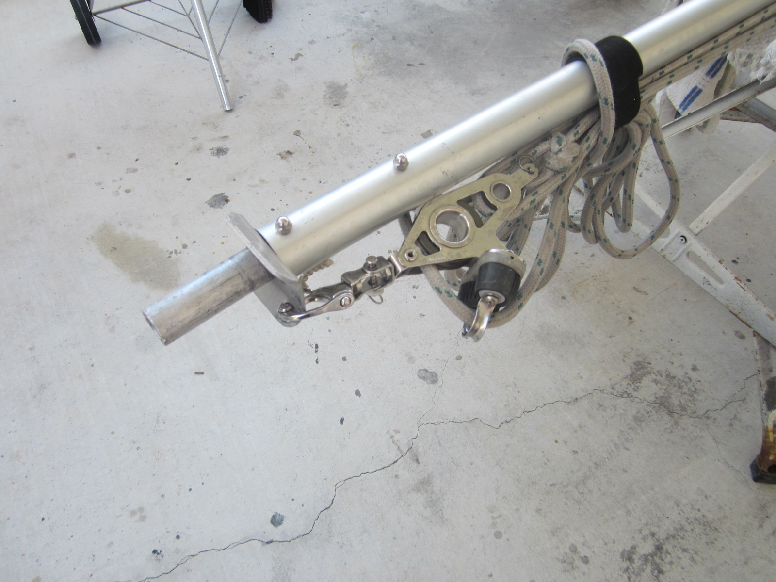

How do people attach the gin pole to the bottom of the mast. I have a plate at the bottom of the mast with 2 pins. I pull the front pin and pivot the mast back on the rear pin. When mast is down i walk the mast forward.

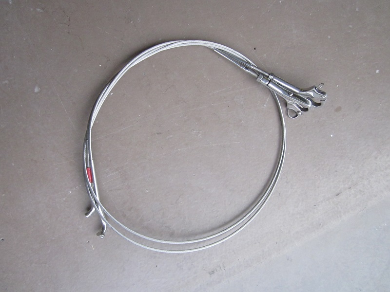

The key to the mast raising pole is a hole near the base of the mast must be a little larger than the pole itself. The end of the pole must be cut to contour to the back side of the mast to include the ridge inside for the sail slide groove. The attached wires must be sideways in parallel so there is no slack in the cables when the mast goes up or down. Suggest for the wires a t toggle with t toggle base attached to mast and pelican hook on the other end for quick release.

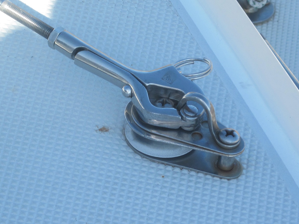

Quick release levers are OK if used in the correct locations, or if you are paying attention to load ratings. I use quick disconnects on the baby stays, as they do not carry that much load. If they did release, it would not be catastrophic. The side stays are permanently attached, and are never removed.
As far as stepping, the baby stays are moved to an alternate location on the cabin roof, that is in line with the pivot point of the mast step. This holds the mast from swinging back and forth as it is being raised. Also the gin pole cleats to that point as well, so it is held stable. Once the mast is up, the jib halyard is used to hold the mast up, while the forestay is attached. I usually winch the jib halyard, to put some bend in the mast, so I can get the foretay attached. Normally my mast is up and done within the first 15 minutes of arriving near the ramp. I can get the boat from road to the water in a half hour by myself if I really hurry. I have a specific sequence that I go through that is the same every time to minimize steps, and not waste time thinking. (thinking will triple the time it takes)

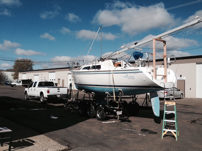

It's been a while since I looked at the site, and so I'll clarify some of the points made.
First, the boat pictured in my post is not a C-22 Sport, it is the C-22 MK-II. Completely different boat in the C-22 line. All the other C-22 versions, including the C-22 Sport, use the same hull. The MK-II is a wider hull. The factory came out with their mast raising system when they introduced the MK-II. The mast has two stainless steel fittings in the sides about 5' up where the T-fittings on the baby stays attach. The other end of the baby stays have pelican hooks, which attach to the top of the turning blocks on the cabin top. The baby stays keep the mast from leaning side to side, not the side stays. The side stays don't take over until the mast is probably 95% raised. The gin-pole assembly simply slides into a hole in the base of the mast. The gin pole has a slight angle designed into the base assemble to aid in the blocks having room when the mast is fully in the up position. There is a fitting inside the mast that stabilizes the gin pole once it's placed into position. I would have to say the only similarity between the Hunter design, and the Catalina-22 MK-II design is that they both use a gin pole to raise the mast.
The Catalina mast raising system makes raising the mast extremely easy, and most importantly, safe. I refurbished a MK-II several years ago and I like to show the new owner how to rig their boat. I had torn the tendons in my right shoulder in a bicycle accident and my right arm was completely useless. With only one arm, I showed the new owner how easy it was to raise and lower the mast on his new boat.
