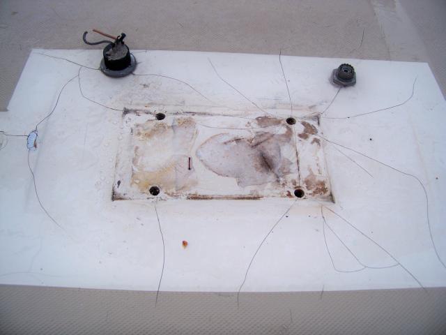

I had a failure of my backstay, the mast fell forward, riping out the mast steps 4 large bolts from the boat.The mast is fine as is the mast step, but an area of 7 X 7 inches where the mast step ripped out is a mess of plywood core and fiberglass, anyone repair something like this? Any suggestions? I have an oday 2o

Please post a picture of the damage.

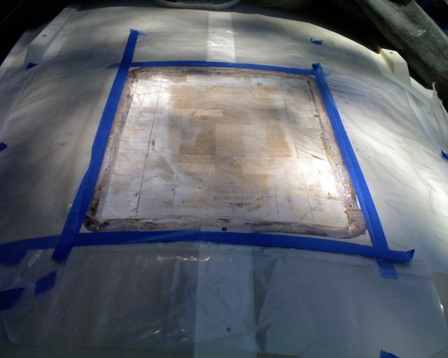

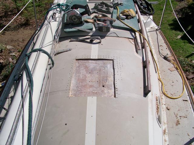

I have just completed a repair of the deck under my mast. The mast plate had been leaking and allowing water to seep into the core. It was rotted out.
If you can post a picture, maybe i can help. Hopefully you will not require this extensive of a repair.:cry:
