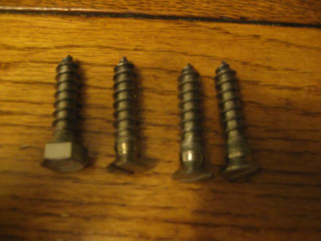

Could not find Them so I had to make mine from 5/16" SS lag screws. I turned the square beards down to countersink heads and cut a slot with the hacksaw.
You were right. Found 5/16" bolts and they appear to be the correct size. Stepping the mast in a day or so, this will be the final proof. Thanks for the input.
