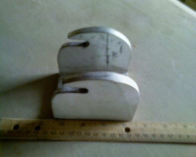

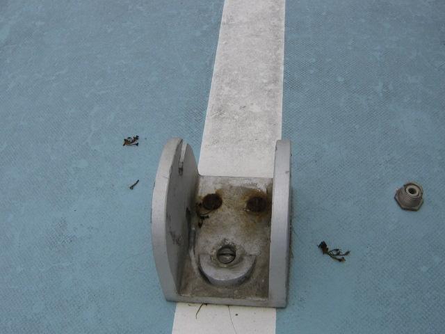

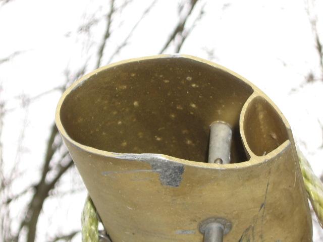

The 31' mast dimension is the mast height off the water, that mast would actually be 27'3" long. However, that is also for the 1980-83 O'DAY 22 which had a taller rig than the 1972-79 models. Your 1977 model would have a mast 22'9" long, which gives a 27'0" height above the water. All O'DAY 22s had a compression post under the maststep, intergrated into the main bulkhead.
Here is the original style mast step/tabernacle for the 22, used on the 1977 as far as I know.

Thanks Sunbird! All your pictures look like what I have and now I can make that pin I see in the bottom of the mast. What was there when I picked her up was a Rusty 6" long 3/8" bolt. I have some 3/8" stainless rod around I can cut a piece from.
