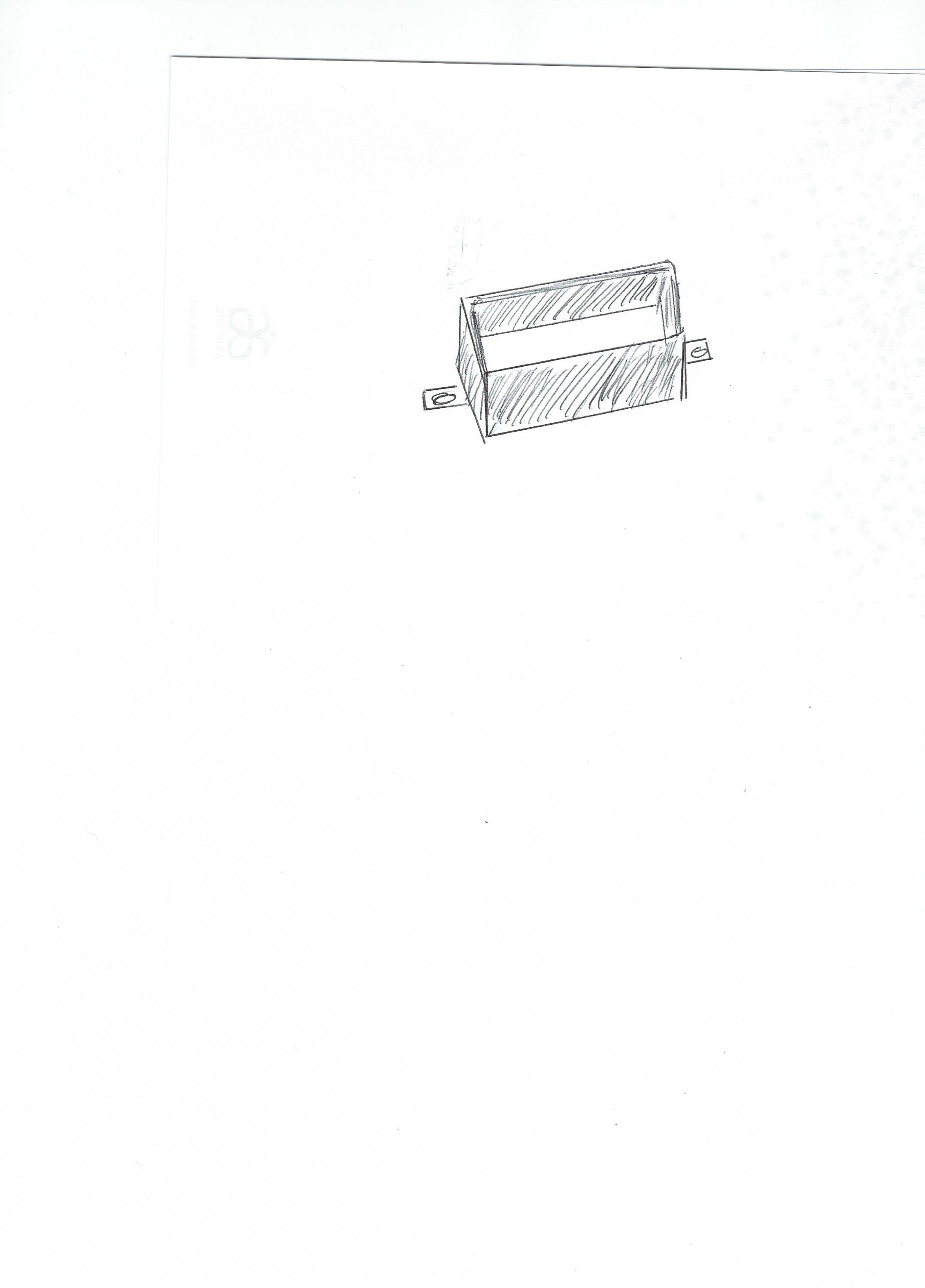

Good day. We've been getting some water drips on the table, apparently making its way from the deckstepped mast of our P-28-2. When we pulled the mast for winter storage, I saw that the shoe has an open center, with no apparent drain/weep hole to the deck area. Any rain that makes it past the sheaves has nowhere to go, though some that runs down the inside of the mast would ooze out around the lip. Coupla questions: Can I cut a slit or drill a small hole at the base of the shoe to allow drainage or am I better off filling the center with some sort of plastic so water has to flow to the gap between mast and shoe? We are on the hard until May, so I have lotsa time to chew on this.
