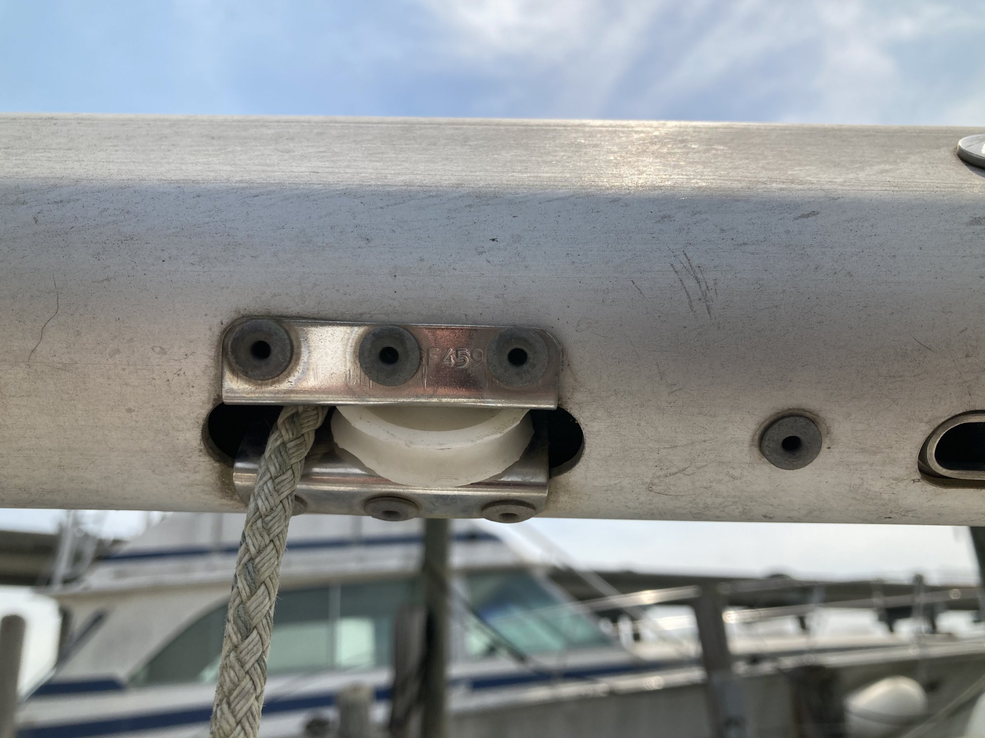

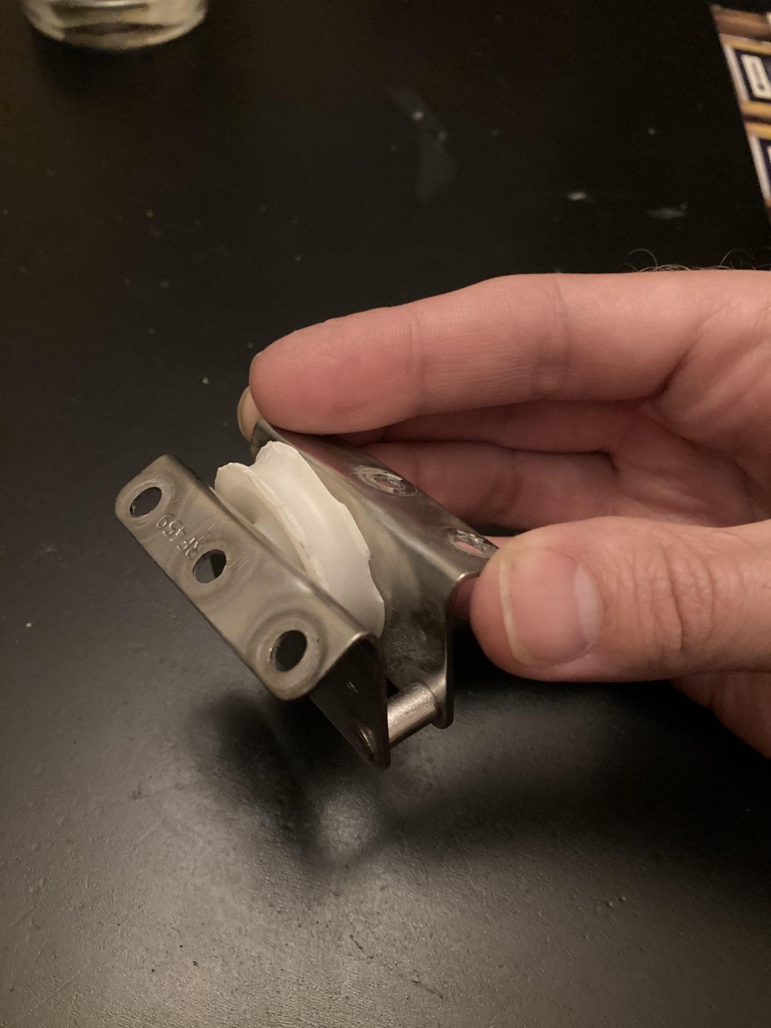

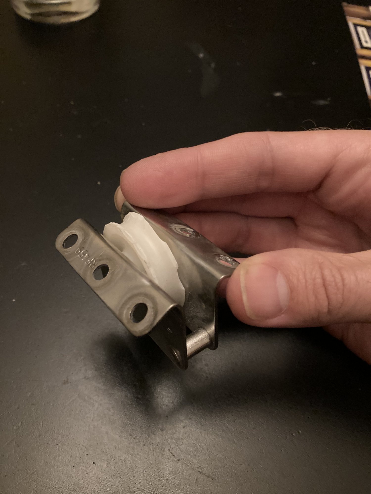

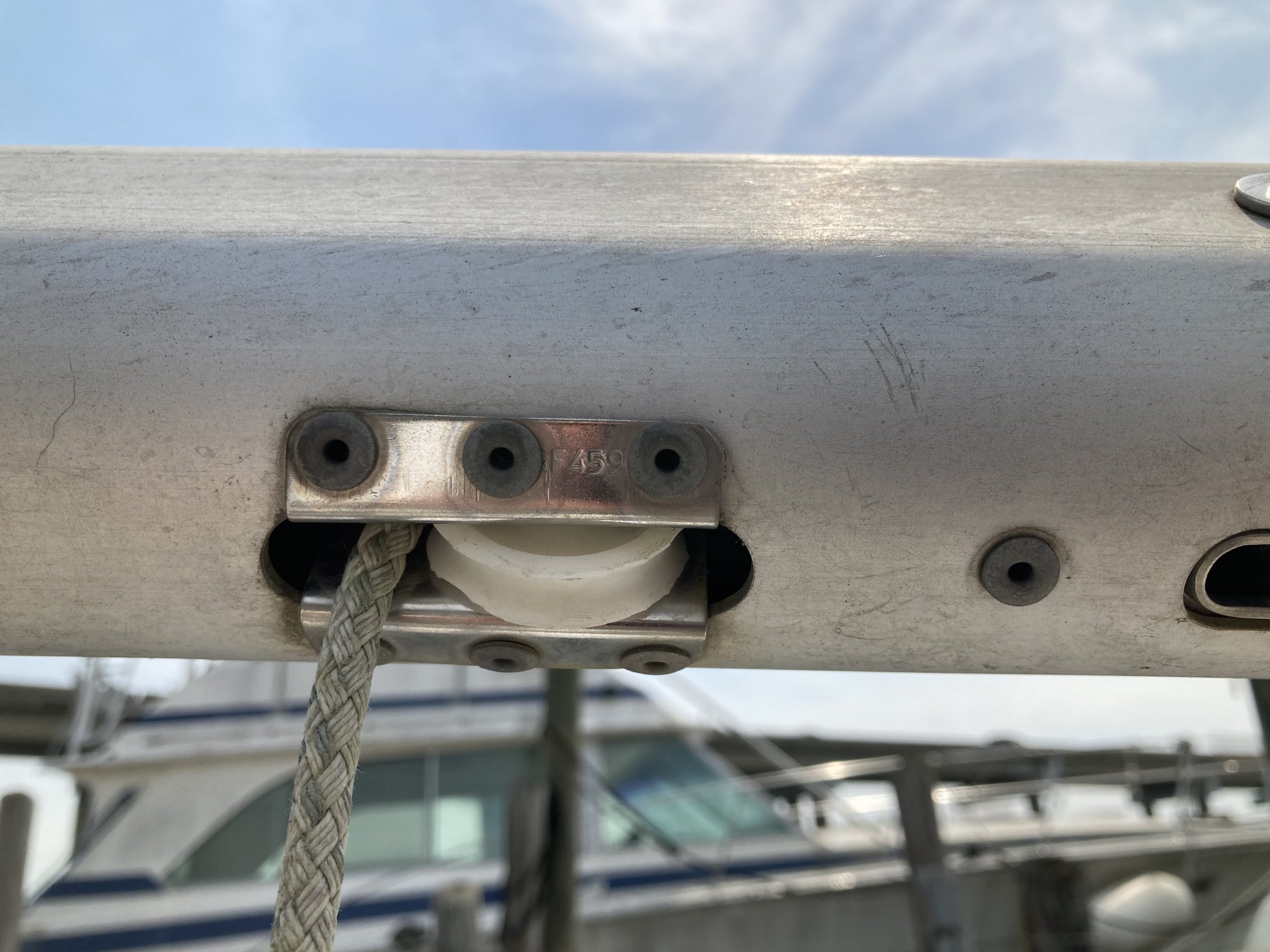

Hi all, I’ve been away from this forum (and sailing in general) for some time as life moved me in other directions, but I’m finally doing long overdue maintenance to get me back on the water. Among other things, I need new sheave boxes for spin and job halyards.
Hoping someone has already solved this problem - What current Ronstan product is the equivalent to RF459? That’s what I pulled out of the mast, but they no longer make that part. From looking at their site, I think RF41712 would do the trick, but not sure.
Background info: I have an 86 Capri 22. The main and jib halyards appear to be 3/8, and the spin halyard looks smaller - 1/4”?
I appreciate any advice.
*Edited to add photos

Just looked at the added pictures. It is a standard in mast box sheave. Typical for a jib halyard on a fractional rig (not a mast head)
Yes the sheave has broken down. Time, use, and UV just wear the parts out.
There are similar parts available from a number of stores. Looks like you drilled out the rivets.
Your on the right track.
